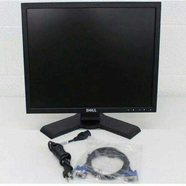

Just wanted to ask, baka meron sa inyo naka encounter ng monitor problem that I have. Attached is a Dell monitor that I bought. 2nd hand but perfectly ok naman... until one day, bigla nalang siya dumilim. At first akala ko power cable probs. Pero may ilaw yung monitor, parang naka standby (amber light). Pag pinapatay ko and then turn on... mag on... pero few seconds, didilim ulit. When you look closely, open pala... pero sobrang madilim.
Is there a combination button that I can press? Feeling ko may napindot yung anak ko e. Hope someone might be able to help. TIA!ac00914171027f434e6c90cda9f6defc.webp
check mo na lang yung settings dito lodi:
Adaptive Brightness is enabled in Windows 7.
To disable Adaptive Brightness, either run Services.msc or go to Control Panel-> Administrative Tools -> Services and set Adaptive Brightness to manual or disabled.
You have You do not have permission to view the full content of this post. Log in or register now. (automatically adjusts picture based on content on screen) enabled in your display settings. This means that you're not using the "Standard" color preset (setting not available in all presets), e.g. "Gaming", "Movie".
To stop this behavior, you can either:
  1. Change your preset to one that doesn't use Dynamic Contrast (e.g. "Standard")
  2. Turn off "Dynamic Contrast" in your display settings
TS, Check mo yung vga cable, kung malinis ba yung plugs at sockets, kung wala bang sira yung cable, try mo i-replug, baka walang signal na umaabot sa monitor. Kung ganoon pa rin, may problema sa backlight/power supply ng monitor mo, pa-check mo na sa technician.
ok naman yung plug. Like what I've said... when you look closely... super dark, pero nandun yung display. Pag open ng computer... meron.. tapos di pa nga nakakaboot sa windows madilim na.
hindi praktikal magpaayos nyan ts, kung old model ay malamang ccfl backlight na maihalintulad sa isang bulb na humuhina ang brightness sa katagalan, mas maganda bili ka ng bago dahil led na yun backlight at matagal ang lifespan
TS, hindi ko alam kalakaran ngayon sa ganyang repair.
Mainam kung makahanap ka ng tv/computer technician na nagpapalit ng backlight ng monitors, malamang may experience sya sa magka-ibang klase ng backlights. Kung ccfl man ang backlight ng monitor mo, mako-convert niya yun sa LED backlight, mas mura pa ang piyesang pamalit kaysa sa original na ccfl backlight.
