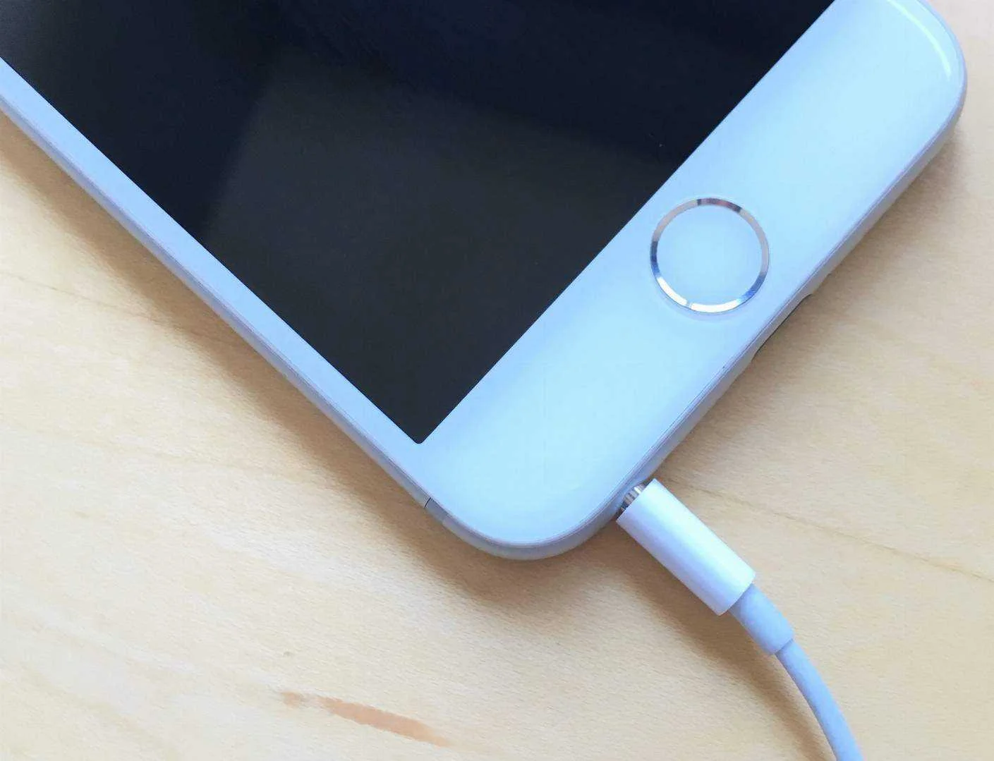

Have you ever unplugged your headphones or speakers from the 3.5mm jack on your iPhone, iPod touch, or iPad just to find that your iPhone was stuck in headphone mode? The most common symptom is that sound won’t come from your iPhone speakers anymore, and in some cases, you may even see the Headphones HUD stuck on your Home screen. It can be frustrating, but it’s usually pretty easy to fix.

So without further ado, here are some steps you can take if your iPhone is stuck in headphone mode after disconnecting a pair of headphones or speakers from the 3.5mm headphone jack:
Plug them back in, take them back out: Maybe iOS hasn’t completely recognized that your headphones were disconnected. Try plugging the headphones or speakers back in out rapidly several times. This may set things right for good measure. It’s usually the best way to fix that temporary issue.
Try another pair of headphones: Not working? Plug in another set of headphones, or another speaker, and then unplug them to see if that made a difference. Some cheaper headphone plugs are made to poorer tolerances, and this can cause iOS to fail to recognize when a pair of headphones or speakers is unplugged.
Reboot your device: If you tried the above steps, but are still in headphone volume mode, try a reboot. This may force iOS to refresh its sound output settings.
Look inside the headphone jack: If neither of the above worked, it could be a hardware problem with the jack itself. With a flashlight, peer inside of the 3.5mm headphone jack and look for any traces of water or lint that could be causing an electrical malfunction. You can typically use a toothpick to clean out the 3.5mm headphone jack out; I’ve done this hundreds of times myself and it works great.
Restore or update iOS: If none of the above are related to your issue, then you may have a corruption in iOS itself. Although rare, this kind of problem may be more common forYou do not have permission to view the full content of this post. Log in or register now., as You do not have permission to view the full content of this post. Log in or register now. that are installed from Cydia, good or bad, can modify system files. Try a You do not have permission to view the full content of this post. Log in or register now. restore, or an update from DFU mode if necessary, and any corrupted iOS files will be replaced with new ones that should function properly.
Contact Apple Support or an Apple Authorized Service Provider: If nothing has fixed your problem, you may have a defective 3.5mm headphone jack. This can happen from over-use or from damage caused by incorrectly-sized headphone plugs that were built to poor tolerances. In this scenario, your only hope is to contact Apple for a repair or replacement, which should be free if your device is under warranty.
