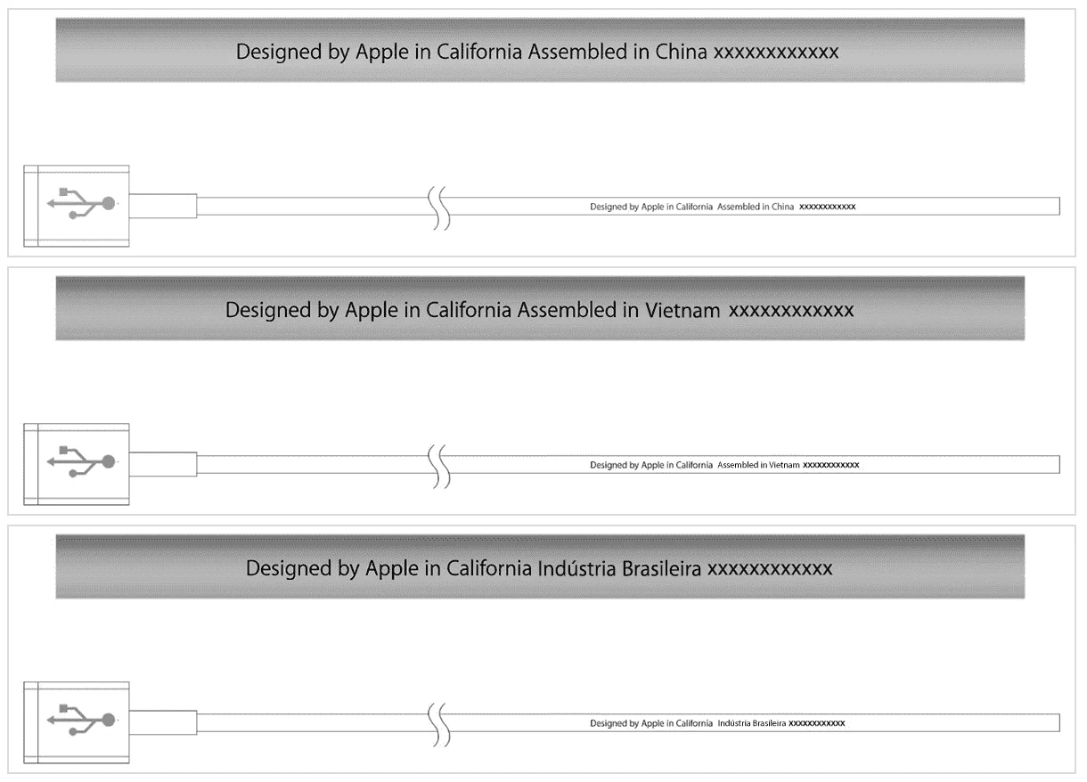

Apple notes that the official cable should say, “Designed by Apple in California” followed by, any of the following: “Assembled in China,” “Assembed in Vietnam,” or “Indústria Brasileira” and then followed by a 12-digit serial number. What’s more is the text is usually found on the rubberized wire about 7 inches away from the USB end of the cable.
Examples below:

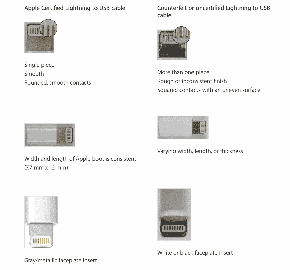

Another thing to look at is the Lightning end of the cable. You should look carefully at it to identify whether the cable is OEM or counterfeit. OEM cables are always high quality and made of premium materials, as are MFi certified Lightning cables. Third-party knock-offs or counterfeit cables are going to have skimpy build quality and show signs of poor craftsmanship.
Apple says some of the things to look for are:
  • Make sure the Lightning connector is a one-piece design
  • Make sure the Lightning connector has a smooth finish
  • Make sure the contacts on the Lightning connector are rounded and smooth
  • Check for consistency in the white plastic boot’s width
  • Make sure the face plate insert is gray or metallic
Examples below:
As you can see, third-party cables that are either counterfeit or uncertified are going to show signs of lesser quality, such as having a multi-piece Lightning connector design that could break off, rough or uneven surfaces that could wear down your Lightning port faster, poorer quality Lightning boot and face plate.
