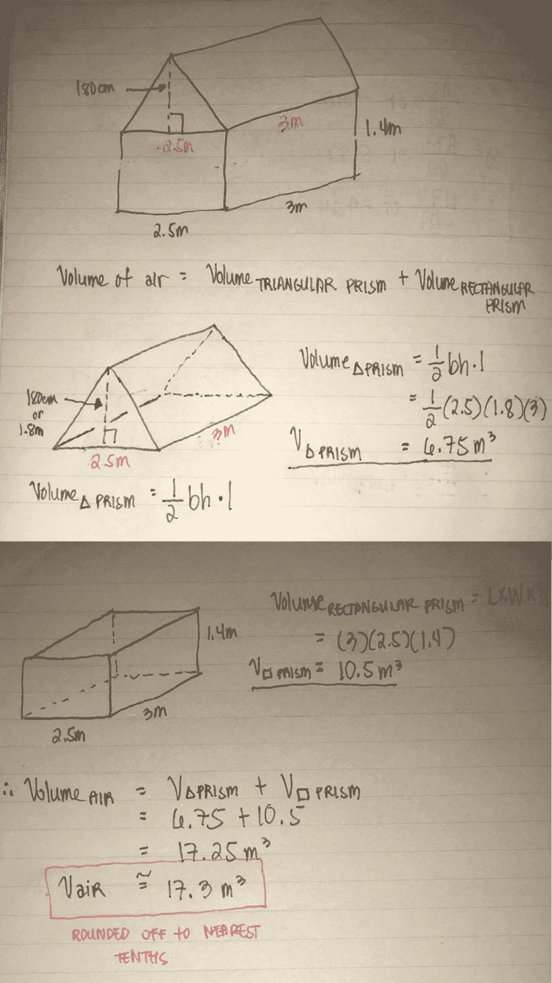

Solved by verified expert
Please refer to the photo for the full solution and figure guide.
Volume of air basically means total volume of the playhouse
Based from the figure, I divided the playhouse into two:
- Roof part (Triangular Prism)
- Base part (Rectangular Prism)
SOLUTION
Vair = Volume of Triangular Prism + Volume of Rectangular Prism
Roof Part (Triangular Prism)
* Using projection of lengths from the rectangular prism, you will notice that we were able to get: (in red ink)
  • 2.5m as the measurement of the base of the triangle
  • 3m as the measurement of the length of the triangular prism
  • Convert 180cm (180x10^-2) to 1.8m so we are using the same unit of measurements
Vtriangular prism = (1/2)(b * h) (l)
= (1/2) ( 2.5 * 1.8) (3)
= 6.75 m^3
Vrectangular prism = LxWxH
= (3)(2.5)(1.4)
= 10.5 m^3
= 6.75 m^3 + 10.5 m^3
= 17.25 m^3
ANSWER
Volume of air = Volume of playhouse = 17.3 m^3
(rounded off to nearest tenths)
Hope this helped you better understand this activity/lesson. Good luck!
