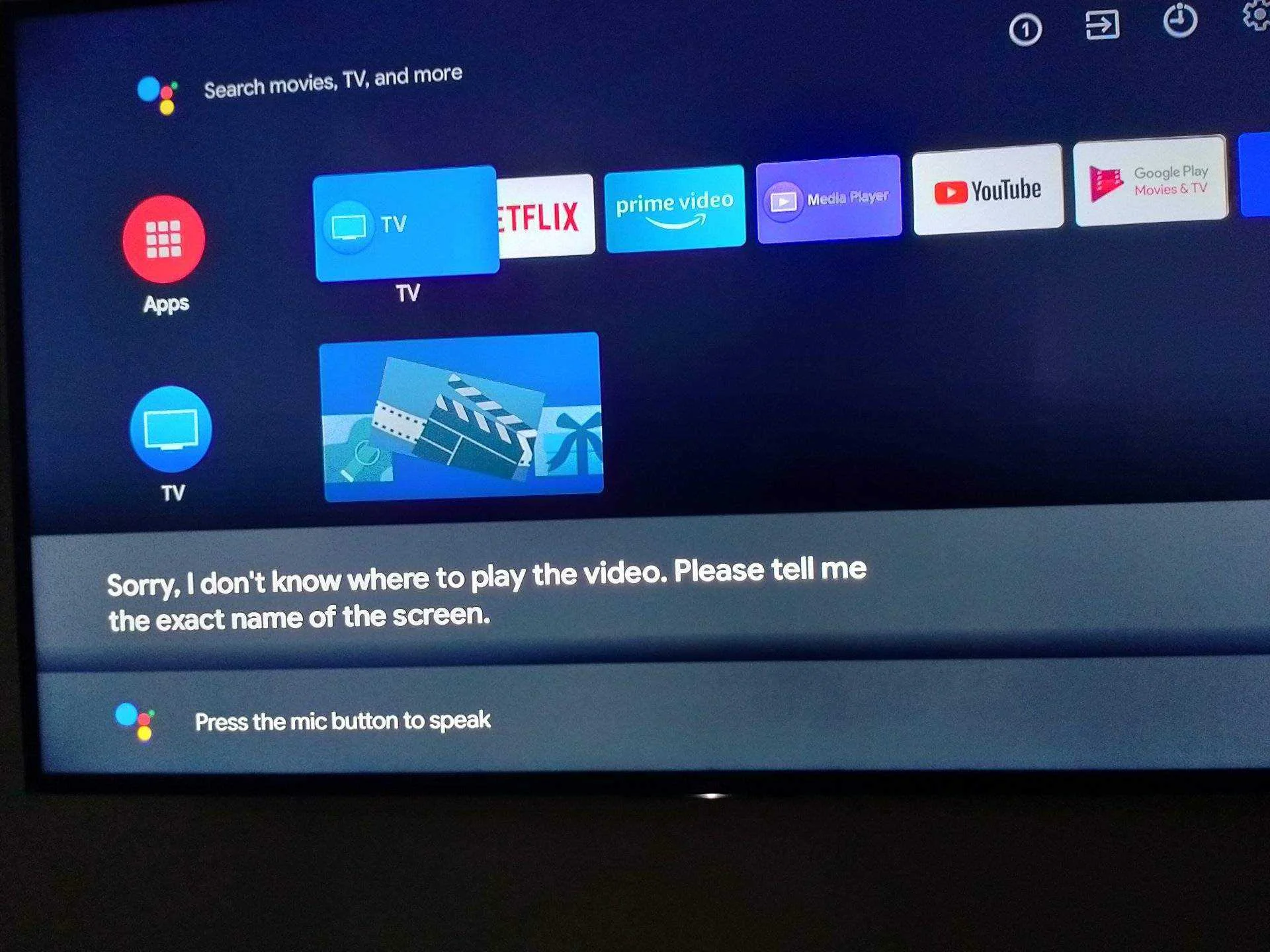

Good day mga ka ph may alam po ba kayo pano ma link yung tapo camera sa android tv?

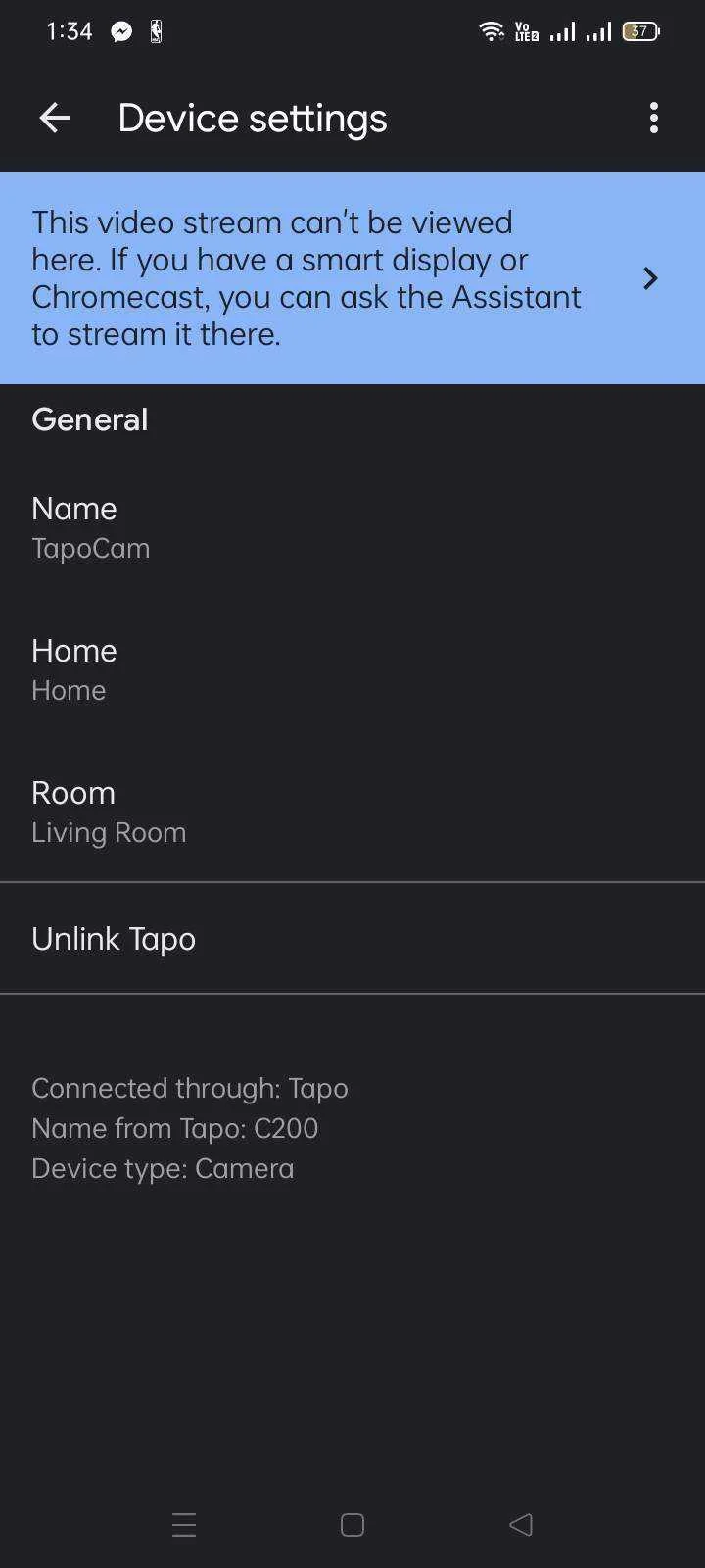

Na add ko na kasi sa Google home yung device tapos sabi ng Google assistant " sorry, i don't know where to play the video, please tell me the name of the screen"
Yung tv namin sony bravia

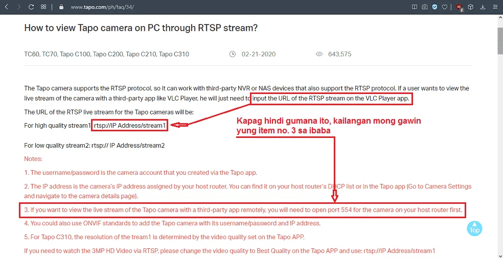

TS, check mo yung screen sharing function (mirroring) ng smart phone at tv mo, pwede iyan. Kung ano yung nakikita mo sa screen ng smart phone mo ganoon din sa tv.

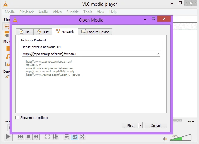

Pwede mong subukan kung mayroong VLC media player yung android tv mo, maari siyang i-setup gamit ang IP address nung Tapo camera. Hindi ko sure kung gagana ito, baka sakali lang.
VLC media player: Click Media > click Open Network Stream... > type the url address and click Play

Working boss maraming salamat po
