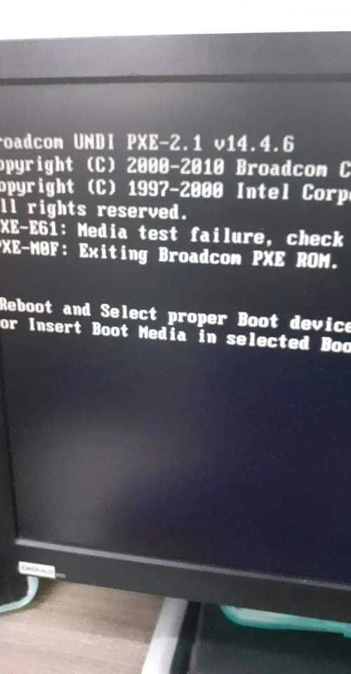

media test failure daw... mukhang deads na hdd/sdd mo, paki-check sa BIOS kung nadedetect pa
if NO : reseat data/power cable ng hdd/sdd, NO pa rin: tech or palit na yan
if YES: baka kelangan lang ma-repair startup/mag-system restore/mare-install yung OS

Hindi na na dedetect master
mas maigi dalhin mo muna sa tech, baka may solution pa sila dyan, and also kung ma-recover pa yung laman for sure mas maganda mapalitan na yan... kesa i-revive lang tapos kung kelan kelangan mo gamitin at biglaan eh saka hindi magamit

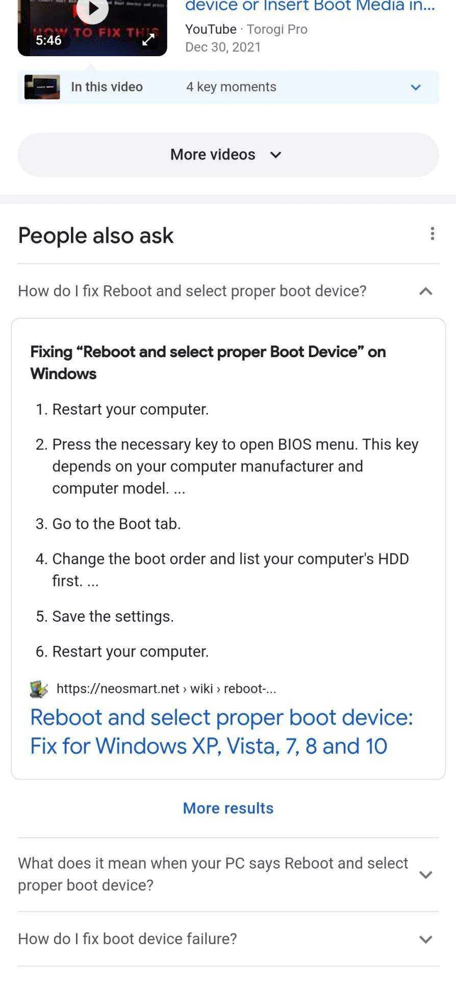

Check the sata cables po kung naka plug ng maayos, check the bios if naka boot priority po yung hdd/ssd mo, do the basic trouble shooting po muna if wala paren palit hdd/ssd/sata cable kase hindi mabasa ng pc
