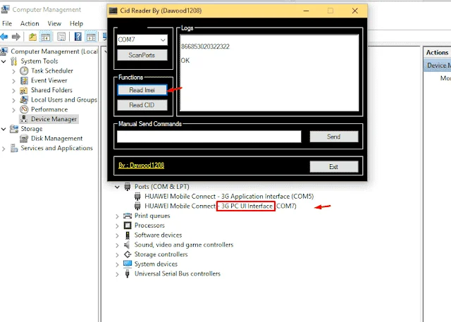

a) Put the right COM port (you can find that on device manager) : sample here Com7.
b) Read Imei (for testing purposes )

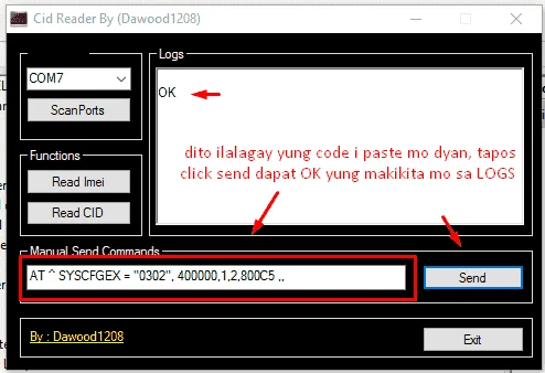

c) Input this three code copy paste on Manual send command
First -Unang code:
at ^ nvwrex = 8268,0,12,1,0,0,0,2,0,0,0, a, 0,0,0
after sending command you will receive OK delete the OK
Second Pangalawang code:
AT ^ SYSCFGEX = "00", 3FFFFFFF, 1,2,800C5 ,,
Third Pangatlong code:
AT ^ SYSCFGEX = "0302", 400000,1,2,800C5 ,,
Kaya ko pina delete yung OK para sure OK yung natangap mo reply kapag 3 OK na unlocked na yan modem mo...
