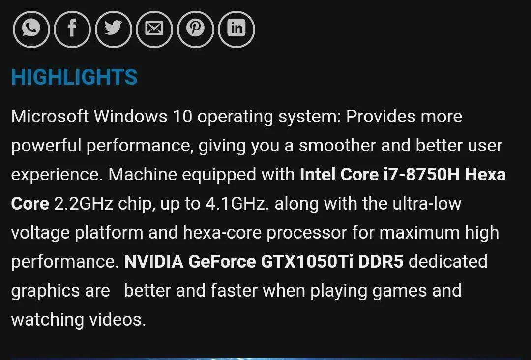

i7-8H 1050ti UHD630 Windows10 laptop

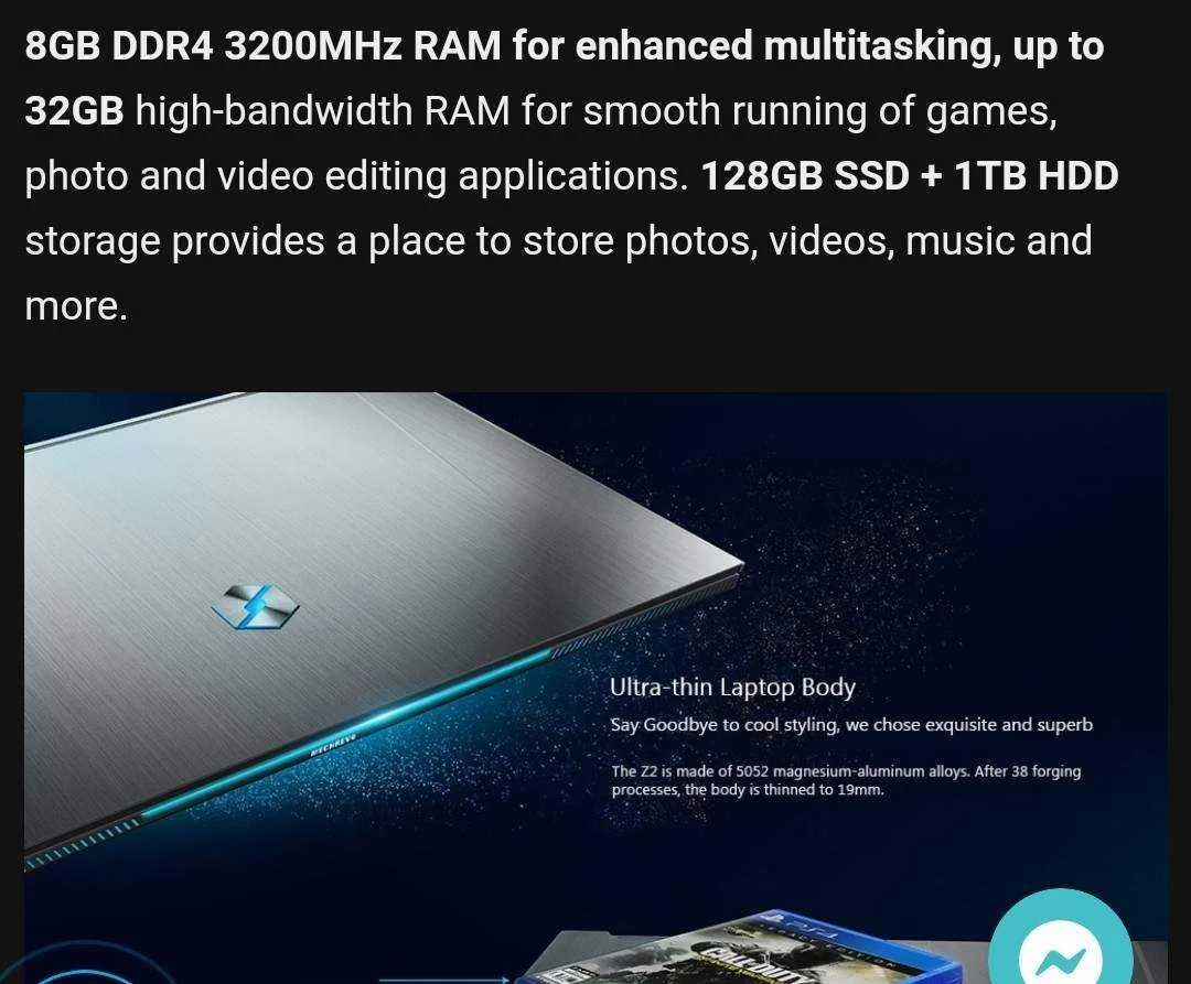

sana may makatulong po. yung hindi need ng Bios thing or reinstall ng windows. IMG_20220323_164903.webpIMG_20220323_164929.webp
