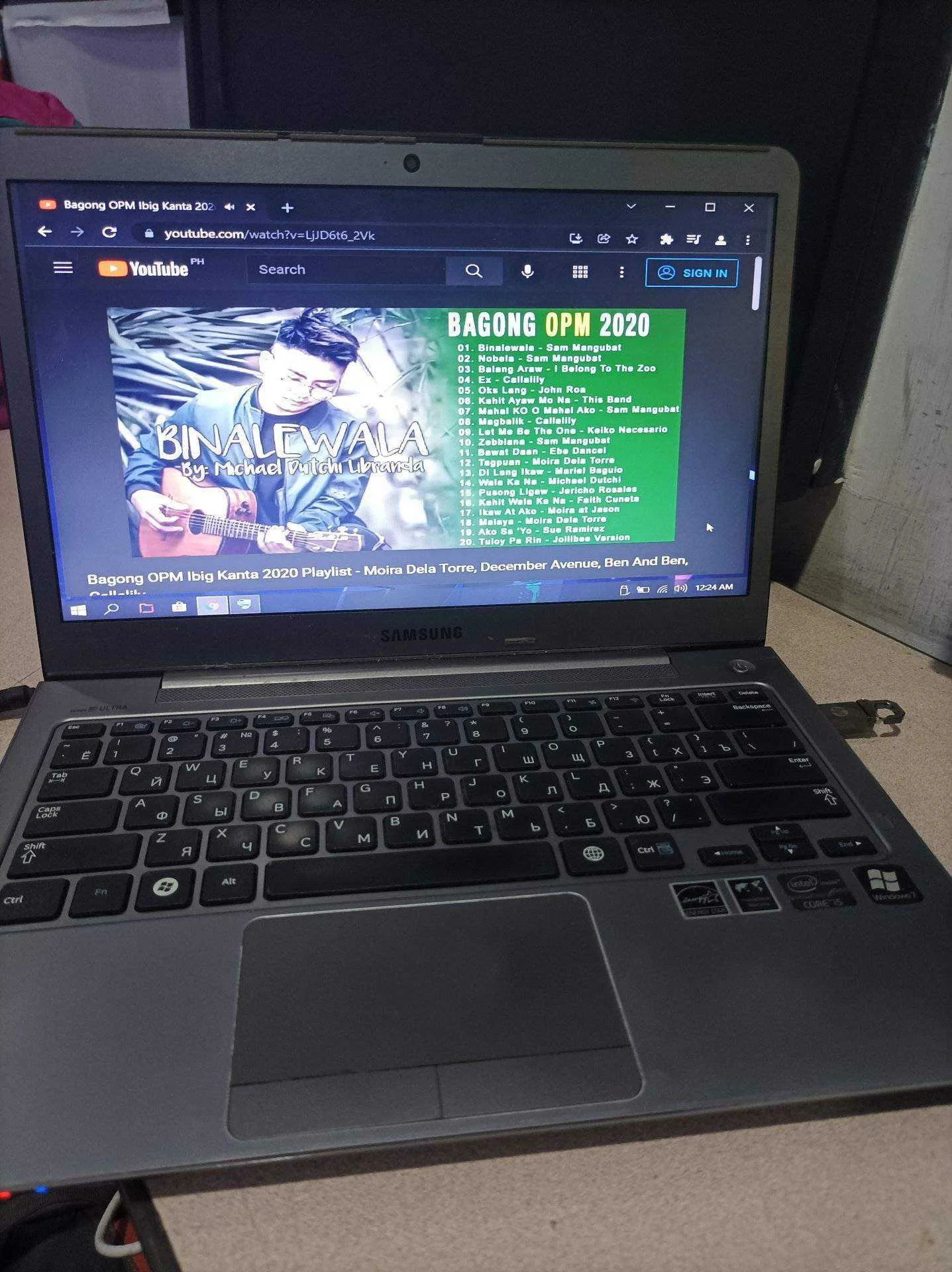

Yung laptop q kc bago lang ung hdd nia ok nmn xa pag iniinstallan ng OS pero pag off ko xa ayaw nia mag tuloy sa windows, unless isalpak ko un bootable usb ko pra mag tuloy then magagamit xa ulit, pag wala un usb s port after ng logo shutdown na xa sana po may naka experience dn at makatulong

Ano kya boss pwd gwin jan kc nung una d nia tinanggap un format ng bootable q . Pinachange ng bios un bootable to MBR pra mainstall c windows tpos yun nainstall q nmn po un windows os nia ..
Check partitions kung same ng mbr or gpt, try to boot sa usb just like installing new windows, sa welcome screen click repair your computer, choose troubleshoot>command prompt> type bootrec /fixmbr then enter>type bootrec /fixboot then enter>if success lahat, type exit>unplug usb then restart your computer and check if Windows 10 can now boot

Sir airmacwave tama ka nga po legacy mode pinainstall napalitan q n and tama po un cnabi mo magkaiba cla so ng try ako ipalit sa aoemi apps from legacy to uefi .. tehn re install ng clean os na uefi gmit sa boot .. gumana MARAMING SALAMAT MASTER 👌🤗🫀
