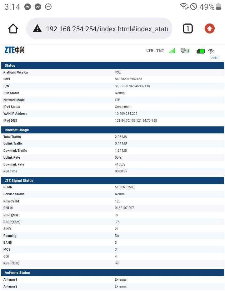

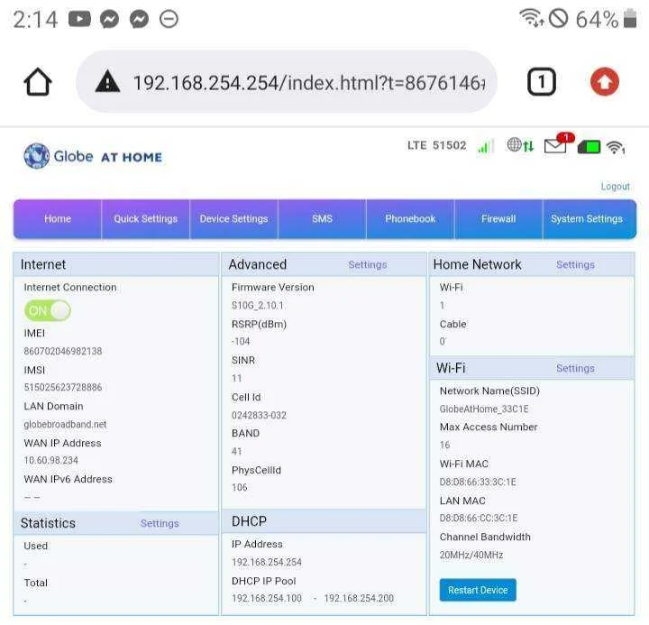

Tips After ma openline yung modem nyu (Important):
1.Hard Reset your modem to apply the changes made by flashing files.
2.In Some cases a LIMITED CONNECTION will occur ,don't panic just reset your modem again and it will fix the issue.
3. Go to DEVICE SETTINGS - ADVANCE - TR06 and change the default config (Production Config ) into STAGING CONFIGURATION. So that your device will not get future updates from Głőbé Ťéľëćôm resulting to lose it OPENLINE status .
Before:
After :
