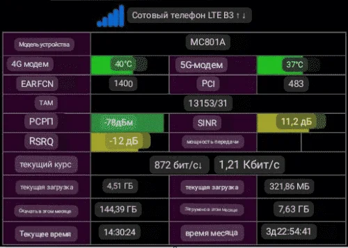

Zte 5g the best, Lods
May Z manager bandlocking, may cell id lock pa
