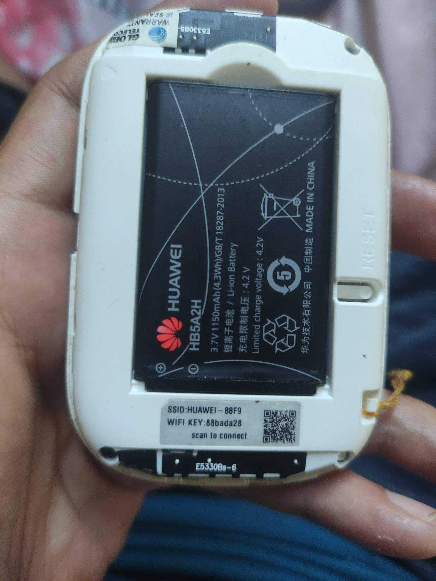

Grave tong E5330Bs-6 nag check Ako Ng mga threads parang wala pa ni Isa sa forum Ang nka kuha Ng tamang unlock code. Hindi Po sya -2 ah -6 Po dulo nya baka Po may alam kayo. Parang di sya kaya ni Huawei Code Generator .
2 attempts left nalang Ako malalock na .
Di ko sure kung pwede I update firmware Ng wifi para magkaron ulit Ng attempts.
Sana merong may idea sainyo mga master Ng "E5330Bs-6"
Ito Po IMEI:
861303031376052

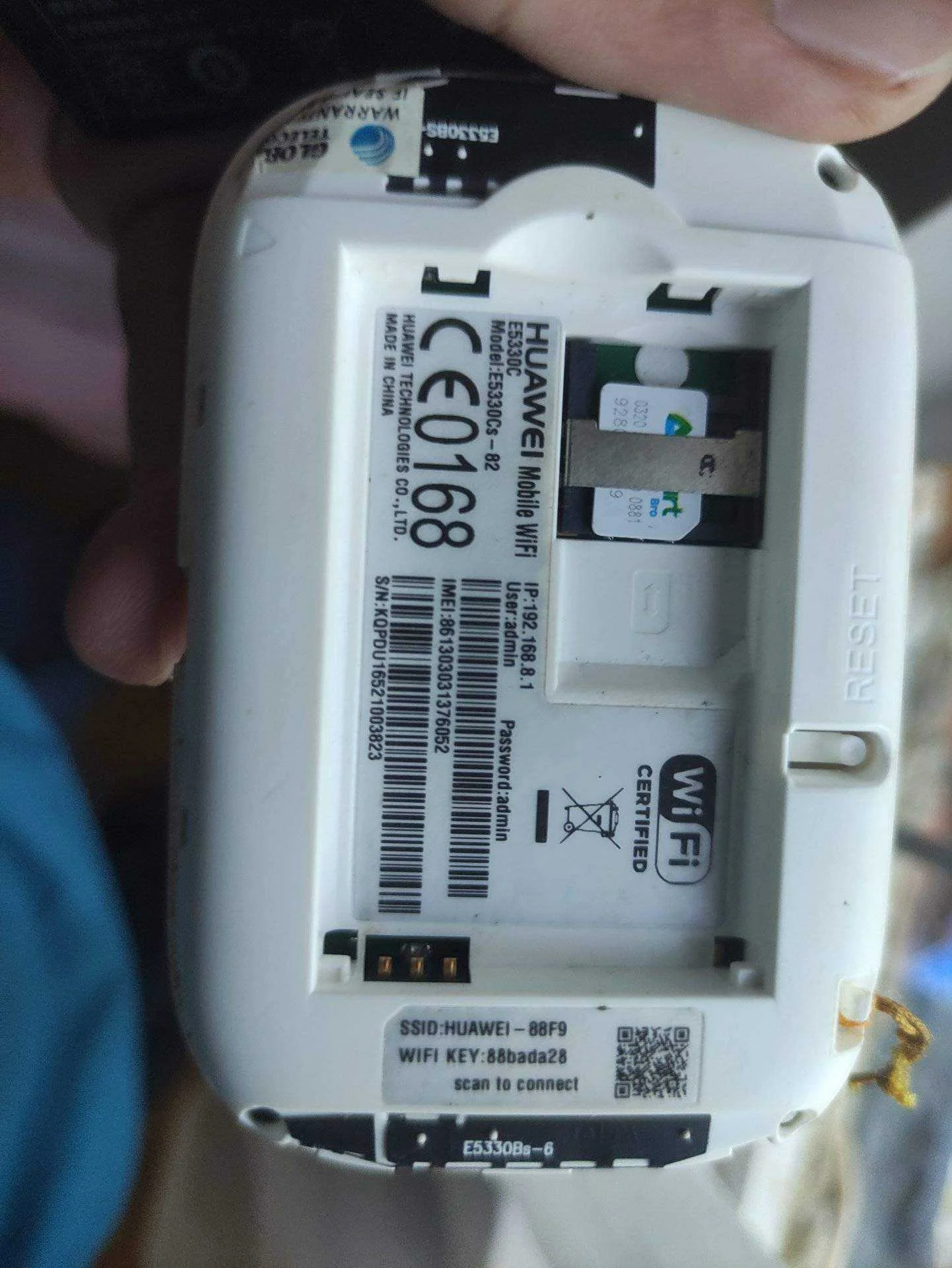

Kung 5330 Cs model inde gagana mga, Lods
Kaya pala inde Working Lods, Cs 82 yan
Customized gl0be firmware yan, wala naglabas mahiwagang teknik jan

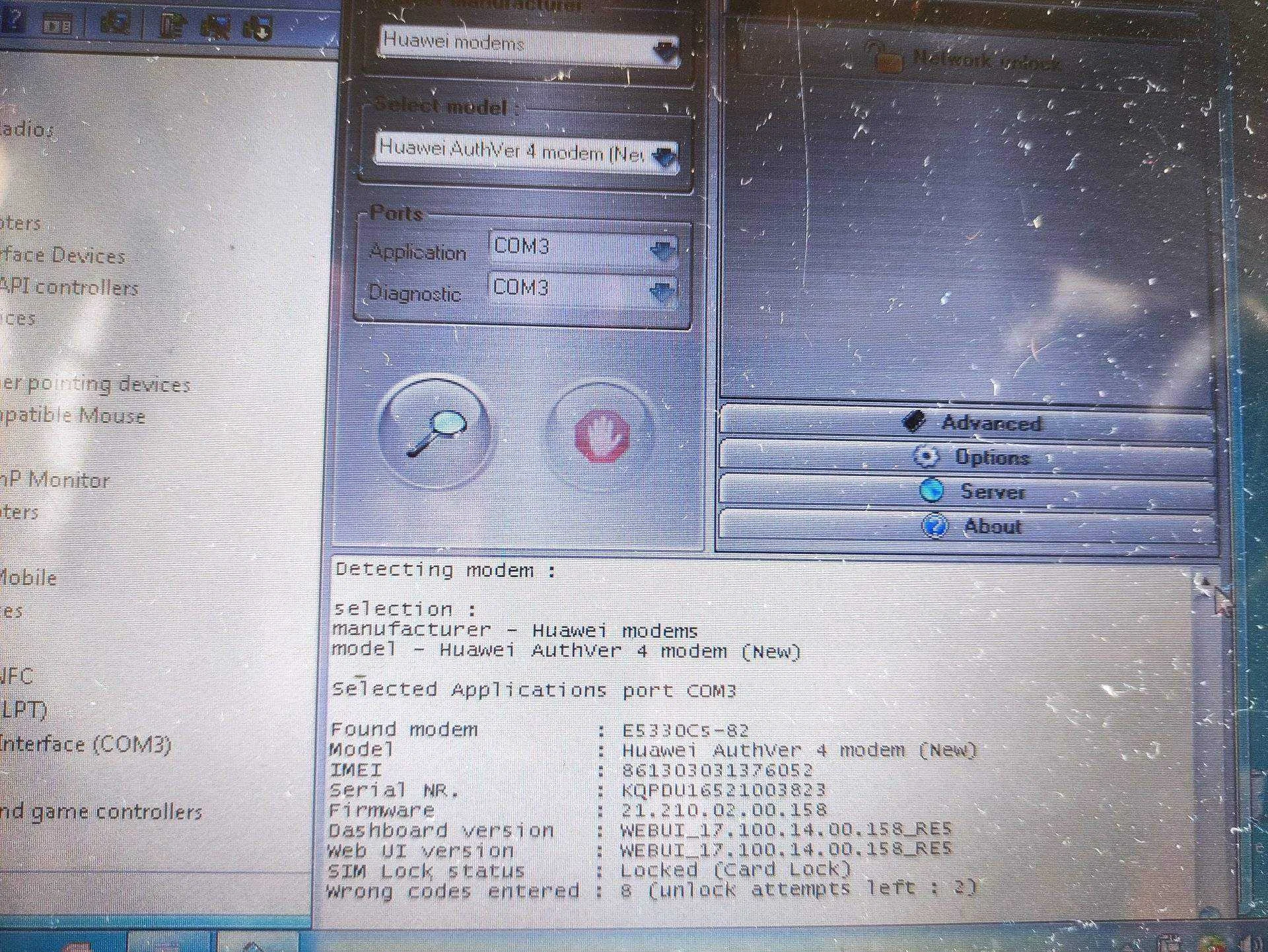

Pero try mo gawin ung v4 unlock code, Dc unlocker
STEPS TO GENERATE HASH FILE :
Download DC – Unlocker Software
Make Sure Device is Connected Properly
Click Read button in DC Unlocker
PUT This Command at The END Of the Results and HIT Enter Button AT^NVRDEX=50503,0,128
A Hash Text Will Display as Result – Copy That
Save The Text in Notepad
Version 4 nga hinihingi master tinatry ko ngayon . Pano na sunod doon sa hash?
Yan master v4 code ang hinihingi

wala pa update boss? sa hash kung pano?
Sir eto try mo bigay lang dito at unang try ko V3 naunlock ko kaya thank you sa nagshare nito baka makatulong sir IMEI Lang input mo mo para magenerate
