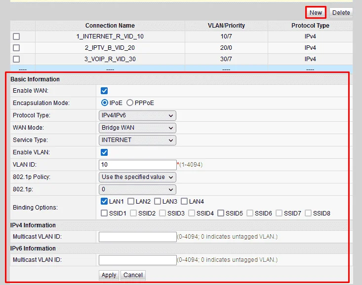

Sana po matulungan nyo ako gamit ko po si PLDT Home Fibr HG8145V5 gusto ko po sana sya iy bridge gamit ang Asus Router but upon checking using superadmin.. yung connection is nka TR069 Internet at sa selection okay naman pede pumili ng Route WAN or Bridge WAN pero yung TR069 is greyed hindi sya pwde maselect. Even iy select ko po sa Bridge at APPLY.. may nagpprompt na this service type is not provided by your ISP. Ano po other option to bypass this, should I create another point which is "Internet" gamit ang same VLAN ID nung nasa "TR069 Internet" or may ibang way po ba? Maraming salamat po!

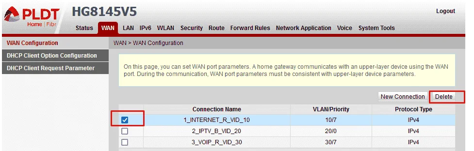

Pwede rin delete, Lods then new muli then apply, lang
2nd option Factory reset, pero madami babaguhin
Factory reset tusok mode lang, Lods. Babalik lahat pero, full reconfigure lahat vlan id
