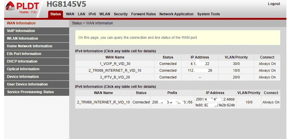

kung halimbawa pldt isp mo, lahat ng devices mo sa home network mo shared the same ip, eg 112.200.2.3 dahil sa NAT. lahat ng devices mo sa local network ay identified by that ip.
pero kung CGNAT yung ini-issue sayo, think of it as nat sa isp level. kaya halimbawa kung yung 10 kapitbahay mo at ikaw ay using the same cgnat ip 100.64.1.1, then ALL of your neighbours' devices, your family's devices, your devices shared the same public ip. kapag nagpunta kayo sa facebuk, google lahat kayo will appear to be coming from the same ip.
Ano implikasyon nito? dahil sa double NAT (nat sa home router mo, at nat sa isp router), some games or apps can be impossible to use. ang option mo na lang ay gumamit ng vpn.

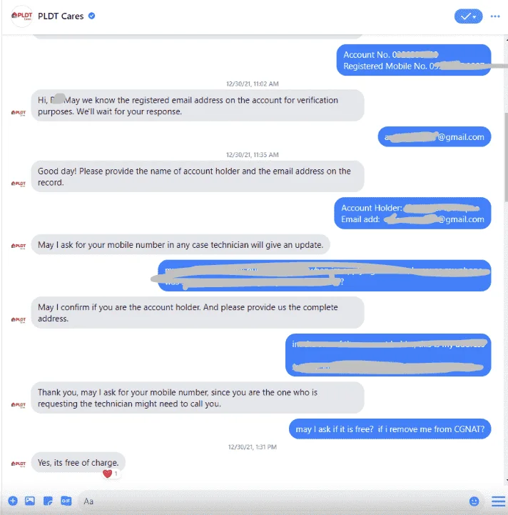

Sanaol pwede mapa unCGNAT by just calling PLDT, samin kasi ayaw talaga kahit anong ulit na ginawa ko, 8 2nd level technicians na ako nagparequest na tangalin sya, and even one time na wala yung profile namin sa PLDT, meaning no internet kami nun for 2 days haha, kaya ayun give up nalang ako total okay naman yung ping nya on games that I've played in.
