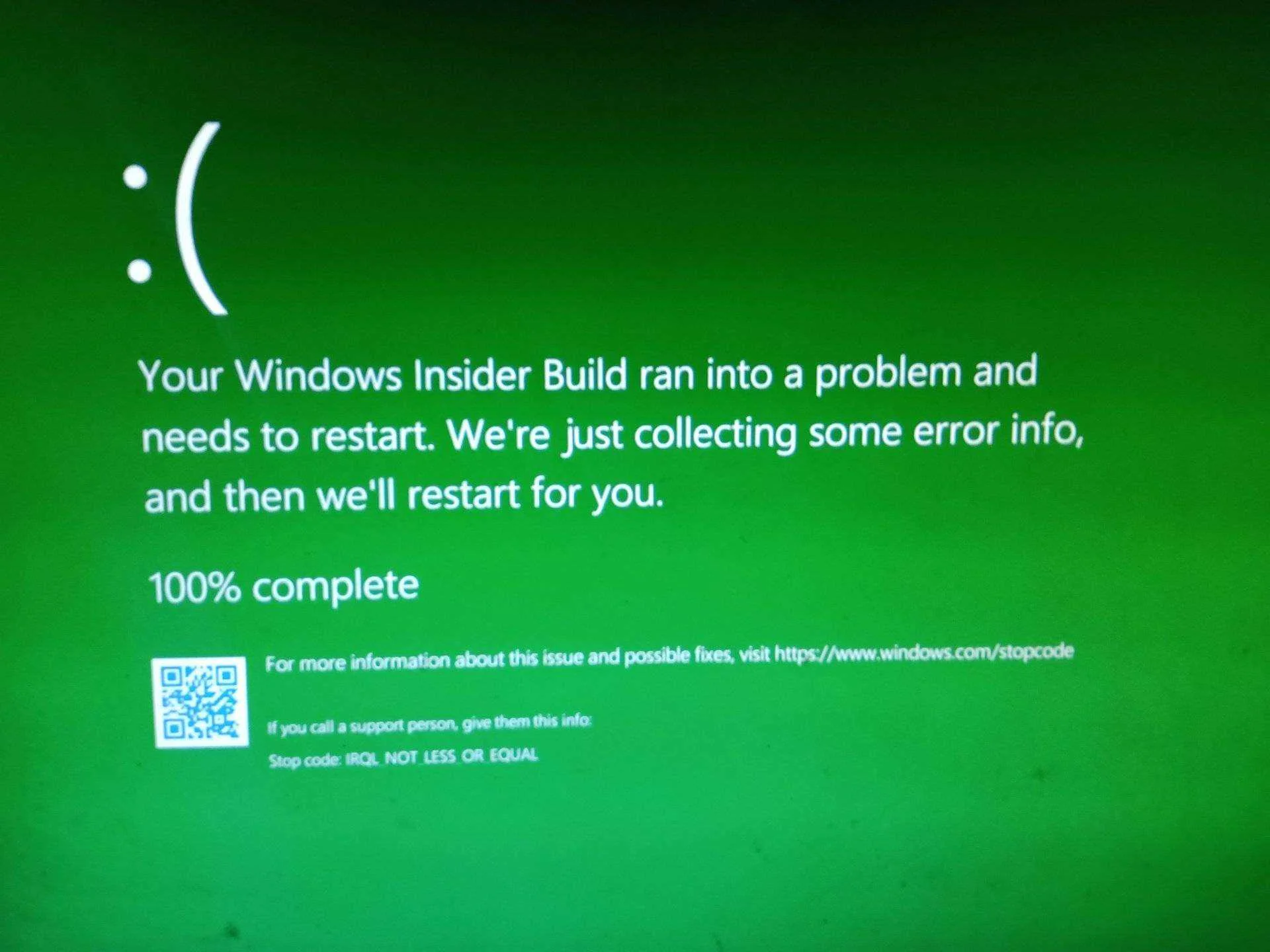

First nag hang yung pc.
First restart ko nag green screen na siya...
tapos ilang minutes I start the pc again peru ayaw na mag on, I mean nag on yung cpu for 2 seconds then nag off siya tapos nag start ulit mag on.. tsaka ayaw mag on ng monitor yung cpu lang nag start for 2 seconds..
Pa tulong naman sa mga pc technician dyan if anong problema? sa windows ba to problema or sa cpu talaga I mean externally? nag stastart yung cpu tapos off ulit tapos on.. hirap e explain.. basta yung cpu laging nag ooff tapos on ulit.. sana may maka intindi.. 😥
Pag ganyang issue pwede kasing Driver, Hardware or Corrupted System Files. Try mo re-seat yung RAM, then boot to Safe Mode with Networking active, tapos try mo run sa CMD "DISM /Online /Cleanup-Image /RestoreHealth". or pwede ring "sfc /scannow". Both of the two given commands pang system file checker.
baka hardware problem na yan, or pwede din may loose lang sa loob

try boot to bios >>> restore factory settings
kung ganun pa rin subukan mo clean and reseat yung ram
dapat mag-invoke yan ng start-up repair or system restore
