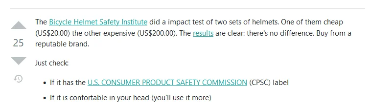

Big Misconception na more expensive helmets are safer​
well, ok yan sir. para yung natipid mo sa helmet, pandagdag sa pampaospital or panglibing.
Helmets Tested​
Our cheap helmets came from Target and Wal-Mart. They cost $9.96, $9.99 and $19.96 and were typical of helmets you would find in any big box discount store. Our expensive helmets came from a bike store, an Ebay seller and an Internet retailer. Two were made in China for US brands. One was Italian. The MSRP for them was $149.99, $174.99 and $206.99. We found the first two discounted, but ρáíd full price for the most expensive one. We submitted three of each model for testing.
Test Results​
The surprise for us was that all six helmets performed virtually identically in all the tests. There were a few outlying readings below and above the norm in particular spots, but the averages for the two types of helmet were almost identical. Below is a summary of the You do not have permission to view the full content of this post. Log in or register now., condensing many charts and numbers.

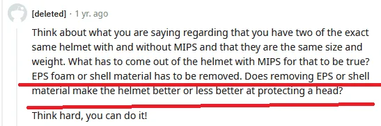

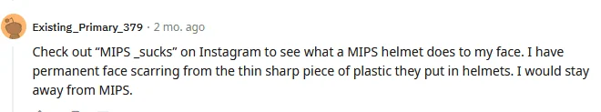

Careful of that statement. Don't always fall for marketing scams. Mas delikado pa pala may MIPS.
Here's why
Tama nga ako mas delikado ang may MIPS dahil babawasan ang EPS Foam at shell to make space sa MIPS
Here's why
