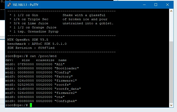

Eto ung naunang bgay mo Lods, pero inde pa unlock
mtd0 hanggang mtd9

Eto na yung sample commands, Bro sa putty or ssh or termux pwede gawin
Directory command show mtd
cat /proc/mtd mo muna.
copy mtd7 to tmp folder
cat /dev/mtd7 > /tmp/firmware.bin
Kapag natapos,
Command in flashing firmware 2 mtd7
mtd -r write /tmp/firmware.bin /dev/mtd4
Downgrade ang ginawa dito, Lods
Syempre kung mag flash ka iba firmware, used andftp, winscp, mobaxterm ilagay mo sa tmp folder ang gusto mo i flash
