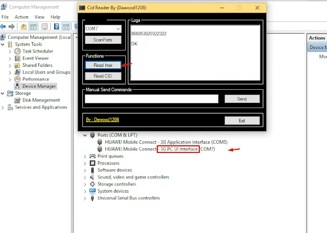

How to Obtain Huawei B315s-936 (Globe) Admin Access:
1) Enter USB mode by following Step 3 of “You do not have permission to view the full content of this post. Log in or register now.”.
2) Run CID reader in USB mode and enter the following commands.
Note: select proper COM port in your CID reader before entering the codes below. To check if you have chosen the right COM Port, click on “Read IMEI”. The “Logs” window should display the modem’s IMEI number otherwise select a different COM Port. Do not edit the codes . You might brick your modem (Joke lang).
3) Enter the following commands:

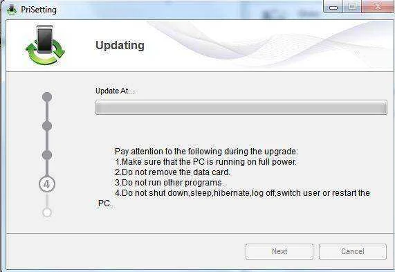

Fifth Code: This will reset your modem. Wait until the modem reboots and shows a
AT^reset
---Steady power light indicator Only !!

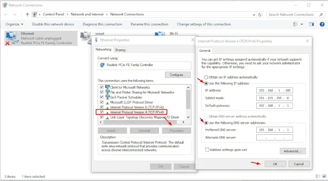

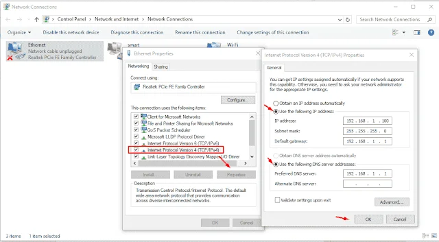

4) Connect your modem to your PC via LAN Cable
Under “Network Properties”, Set IP manually as follows:
click “Use the Following IP Address”
IP address: 192.168.1.100
Subnet Mask: 255.255.255.0
Gateway: 192.168.1.1
Tick “Use the following DNS Server Adressess”
Preferred DNS: 192.168.1.1
Alternate DNS: (leave blank)
Click OK

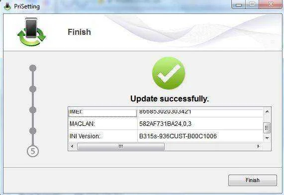

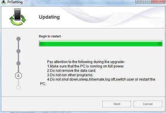

5) Run “You do not have permission to view the full content of this post. Log in or register now.” login kayo user user pero minsan kahit wala start nyo lang and wait for it to complete successfully.
Exit “Config Updater” and reboot modem.

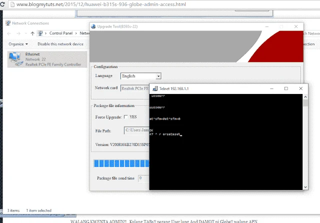

6) Enter USB mode (back to Step 1 USB Mode link)
• Run CID reader in USB mode and enter the following commands:
Pag ayaw mag telnet kayo 192.168.1.1 duon nyo input yan..
Telnet 192.168.1.1
user:admin
pas:admin or
user:user
password:user
First Code : This command will kick your modem out of factory mode
at^sfm=0
Second Code : Resets and reboots the modem
AT^reset

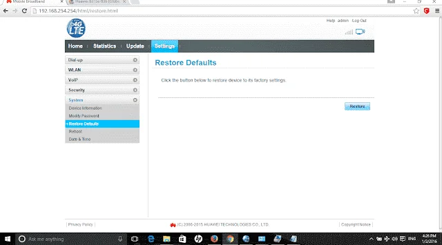

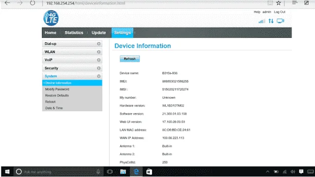

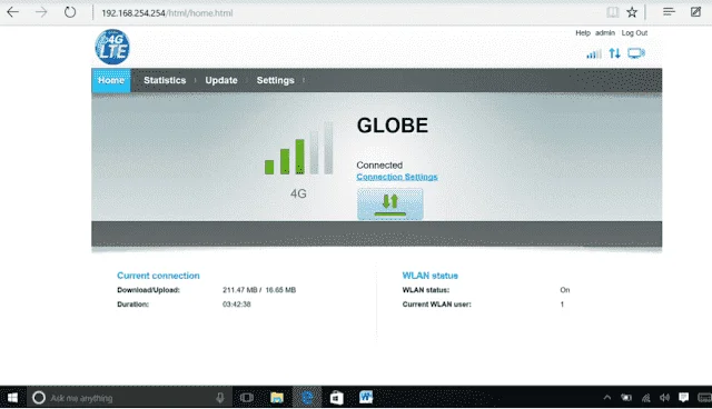

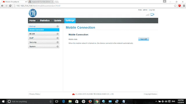

7) After successfully rebooting, go to Network Properties again and click “Obtain IP
Address Automatically” and “Obtain DNS Address Automatically”. Try to log into the
modem’s web interface by typing 192.168.254.254 in your browser.
Login as....
Username: admin
Password: admin
Go to “Settings”.
Choose “Restore Default”
The modem will reboot.
Done. You now have admin access to your modem.

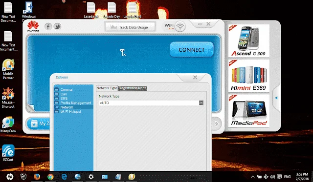

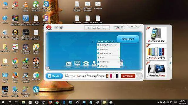

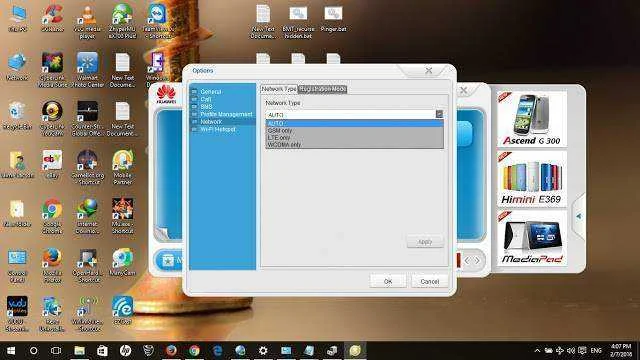

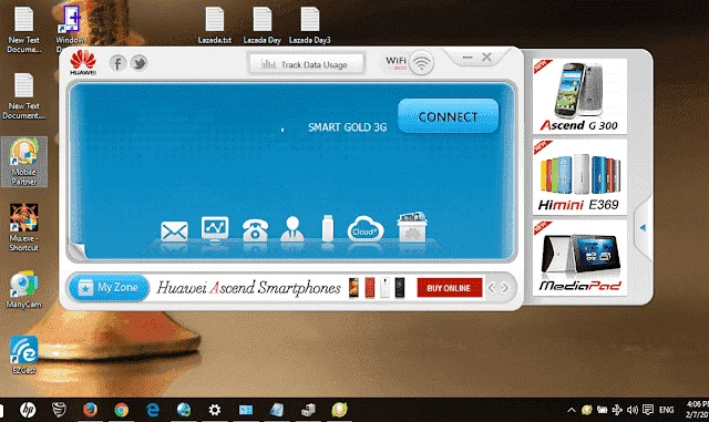

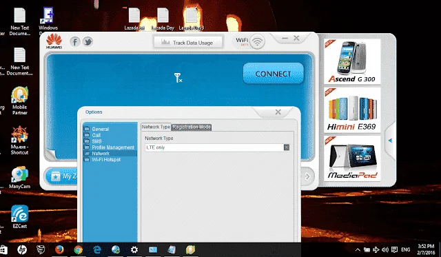

MOBILE PARTNER USB MODE
No Signal if naka Lock sa LTE Only
Gawin mo AUTO yan mag kakasignal na yan
Paano Gawin Pumunta sa Setting Preferences
Telnet 192.168.1.1
user:admin
pas:admin or
user:user
password:user
at^sfm=0
AT^reset
Login as....
Username: admin
Password: admin
Go to “Settings”.
