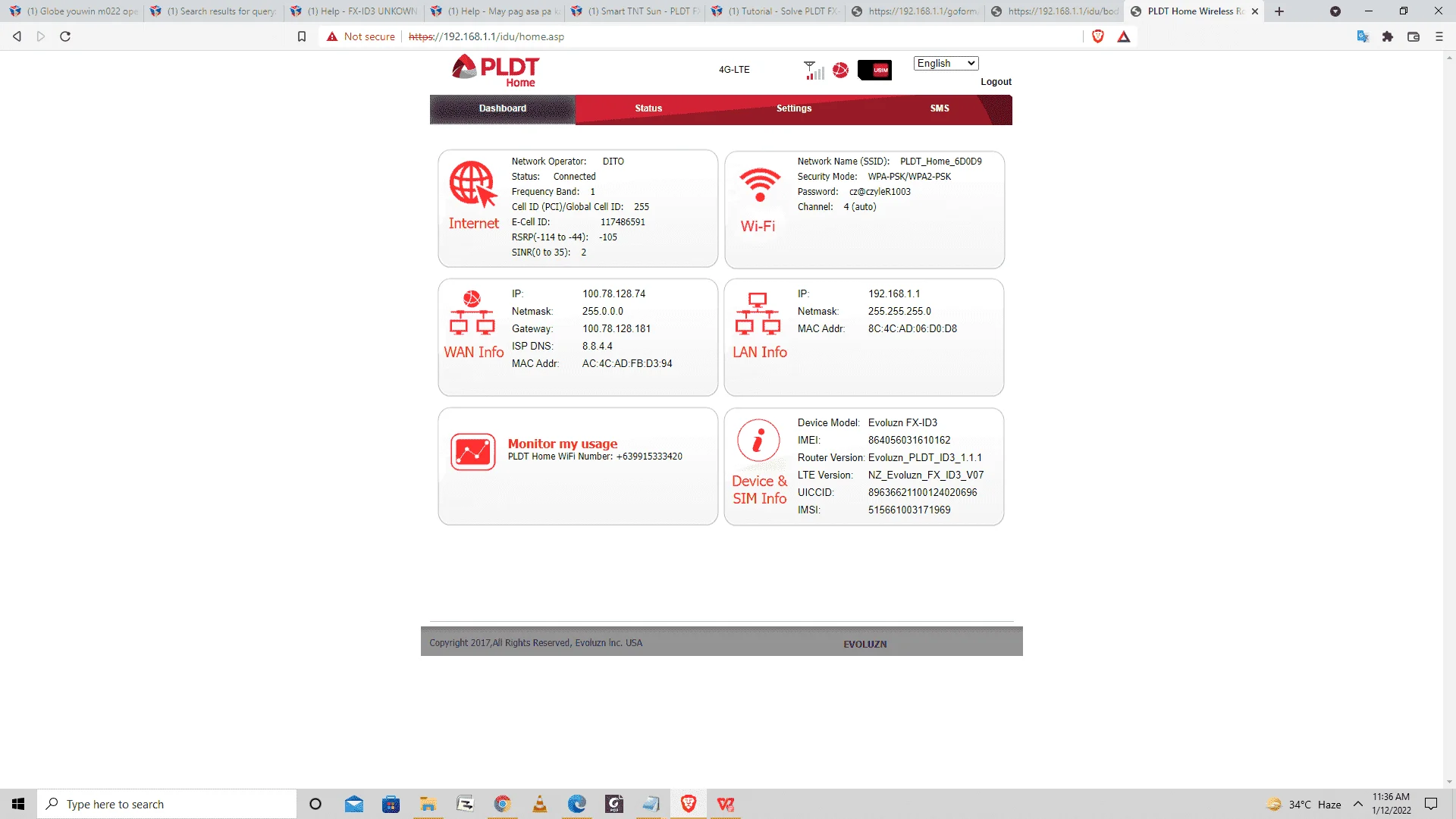

PLDT FX-ID3 1.1.1 Software Version Checking URL CODE:

Paano madowngrade lods version 1.1.1 para bumalik sa dating v1.2.4
Downgrade fx id3 v1.1.1
PLDT FX-ID3 1.1.1 Software Version Checking URL CODE: copy and paste sa browser yang link then upload and browse ung firmware na gusto ilagay
Gamitin mo tong link, Lods kung v1.1.1 pa yan kung baseband v7 na yan, kahit i downgrade mo limited access na yan, d gagana kahit anong sim, mas maganda dapat may mag share v1.1.1 firmware para hinde limited access kung baseband v7 updated na fx id3. kung ma fully block disabled updates para d na mag updates, kac less features mga updater versions at mas slow

Napapasok nman lods ung Band and nag chachange sya. Pero pag restart hindi na kumakagat, bumabalik lng sa dati. Evoluzn_Smart_Bro_ID3_1.1.2.2 gamit ko lods.
San po pwede makaka kuha ng 1.1.1.2?
Or 1.1.1.2.2 firmware original ng smart, simula po kz ng na downgrade q, sa 1.1.1.0 at LTE V05, naging unstable ang DITO signal ko at d na nagcoconnect, gnaya ko lamang po kz ang ky sir jhowel ika kz stable ang gnon, kaso my probs sya sa DITO
