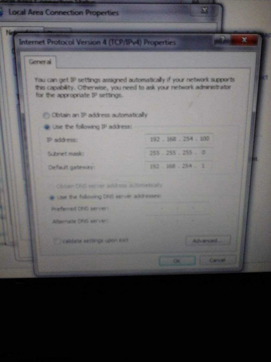

1.SET STATIC IP FROM THE LAST FIRMWARE BAGO MA REMOTE EG. GREEN PANGET IS 10.1.1.254 OR 22M 2012 192.168.254.1 BASTA DEFAULT IP NG LAST FIRMWARE NA GAMIT NYO

8.NOTE:KAPAG LUMABAS UNG "WINDOWS HAS DETECTED AN IP ADDRESS CONFLICT" SET NYO NA IPV4 SA OBTAIN AN IP ADDRESS AUTOMATICALLY.

9.THEN DISABLE NETWORK ADAPTER/ENABLE
GO TO CMD AND IPCONFIG

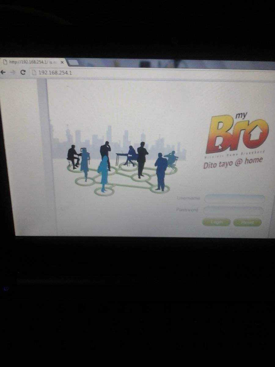

LOOK KUNG OK NA ANG IP AND ACCESSIBLE NA ANG GUI
PAG ACCESSIBLE NA GUI TELNET AGAD USE THIS COMMANDS
