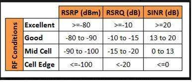

ano po ba gamit mo phone or nka modem ka??
kung phone gmit mo automatic kc nag sesearch ng frequency & network yan d tulad ng modem na pwede ka mag manual search pag naka open line para hindi palipat lipat ng kokonekan!!
SINR/SNR – The signal-to-noise ratio of the given signal.
RSRP – The average power received from a single Reference signal, and Its typical range is around -44dbm (good) to -140dbm(bad).
RSRQ – Indicates quality of the received signal, and its range is typically -19.5dB(bad) to -3dB (good).
RSSI – Represents the entire received power including the wanted power from the serving cell as well as all cochannel power and other sources of noise and it is related to the above parameters through the following formula:

Wala naman problema sakiñ lods ,aabot nga ng 60mbps sa akin,nung una humina sya ,nka 28band ako nun pero malakas pa nmn un nung bago pa kaya baka nlipat nila sa ibang band ung sa area namin kaya pinalitan ko ng band 1 ayun bumalik 60mbps ko,depende kasi sa area nyo yun kung anong band ang malakas
