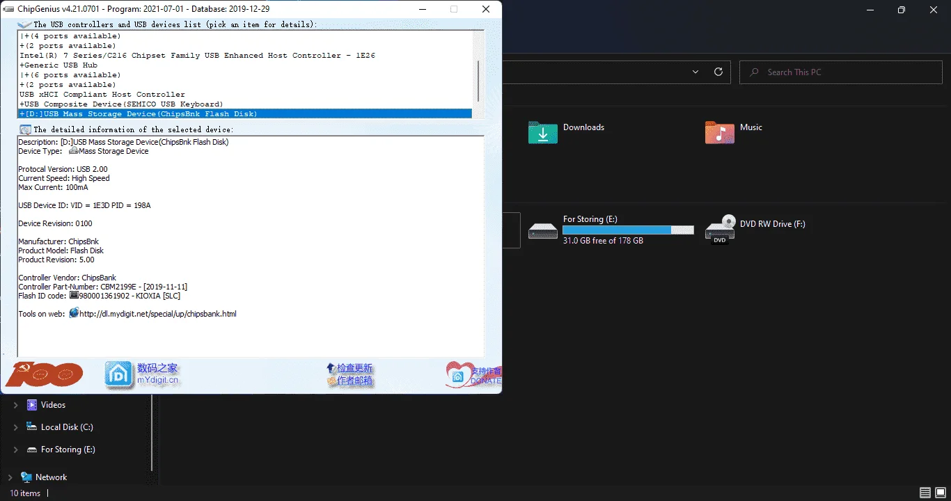

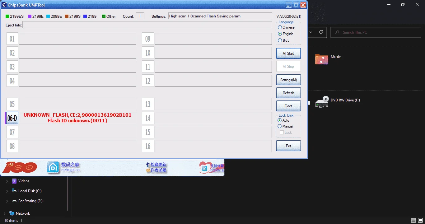

🔒 Closed Pahelp po mafix ang flash drive ko :(
