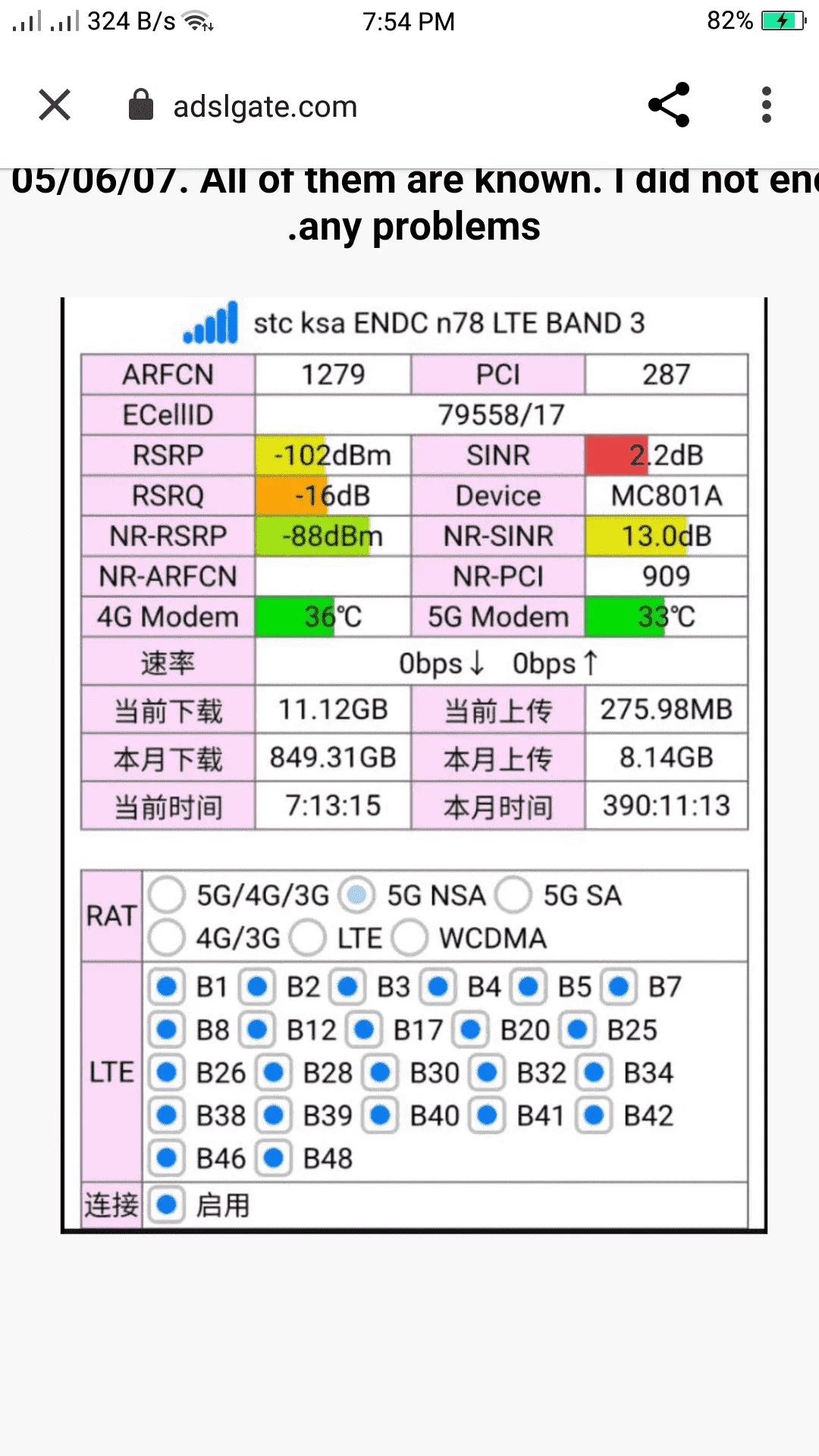

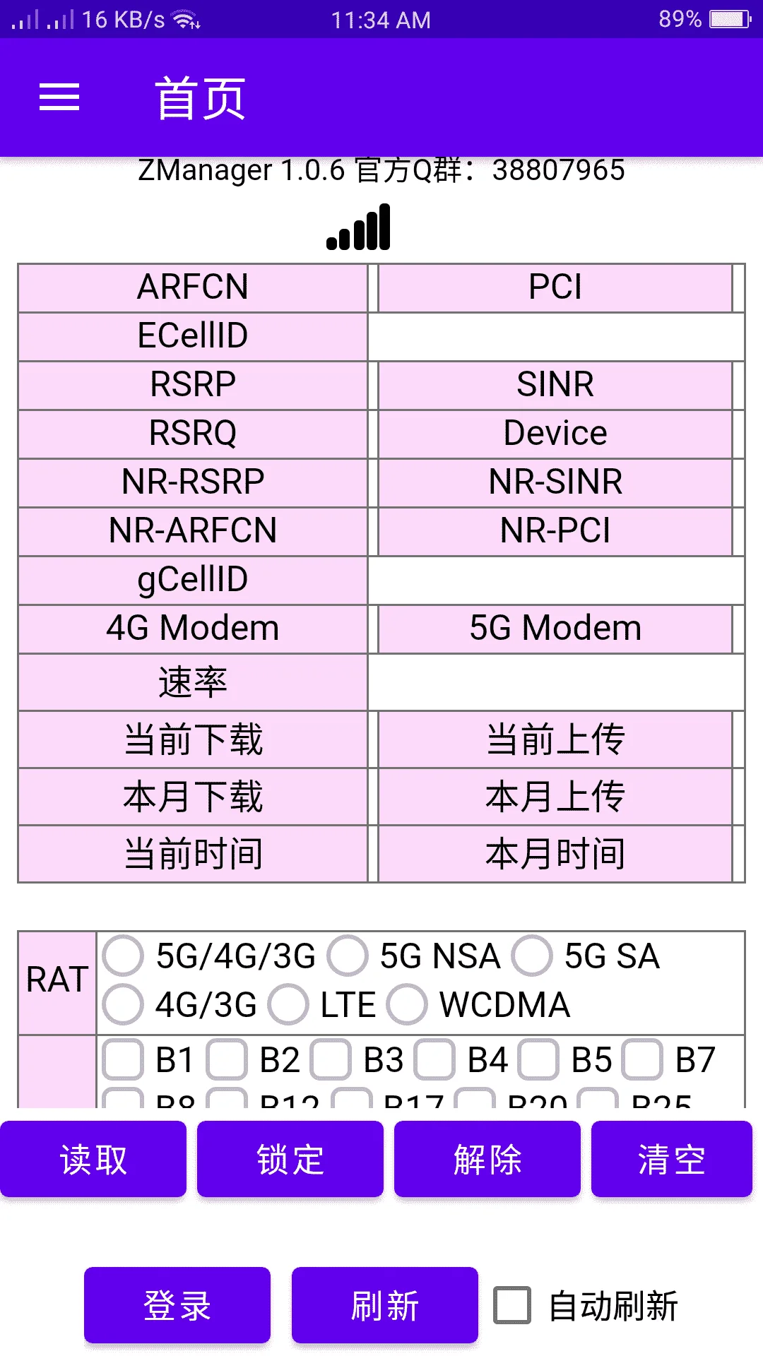

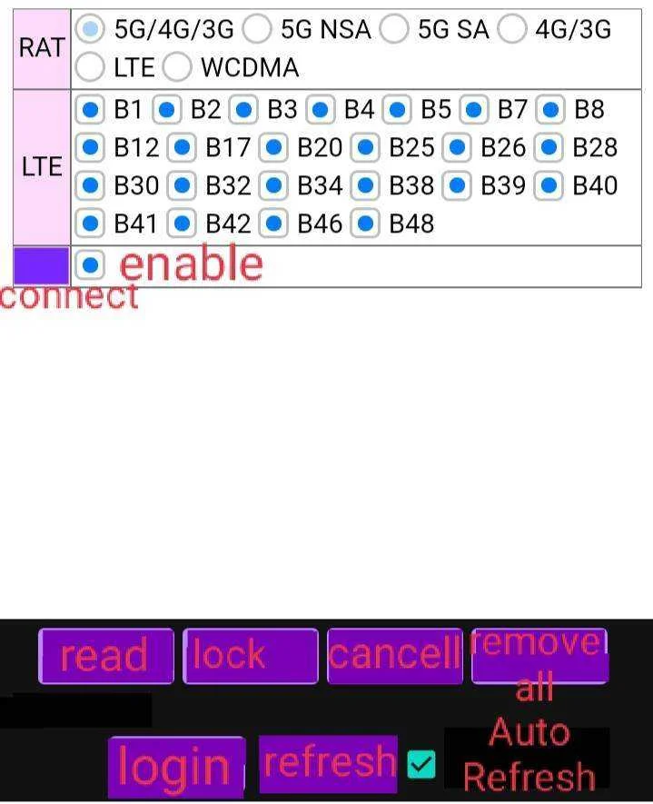

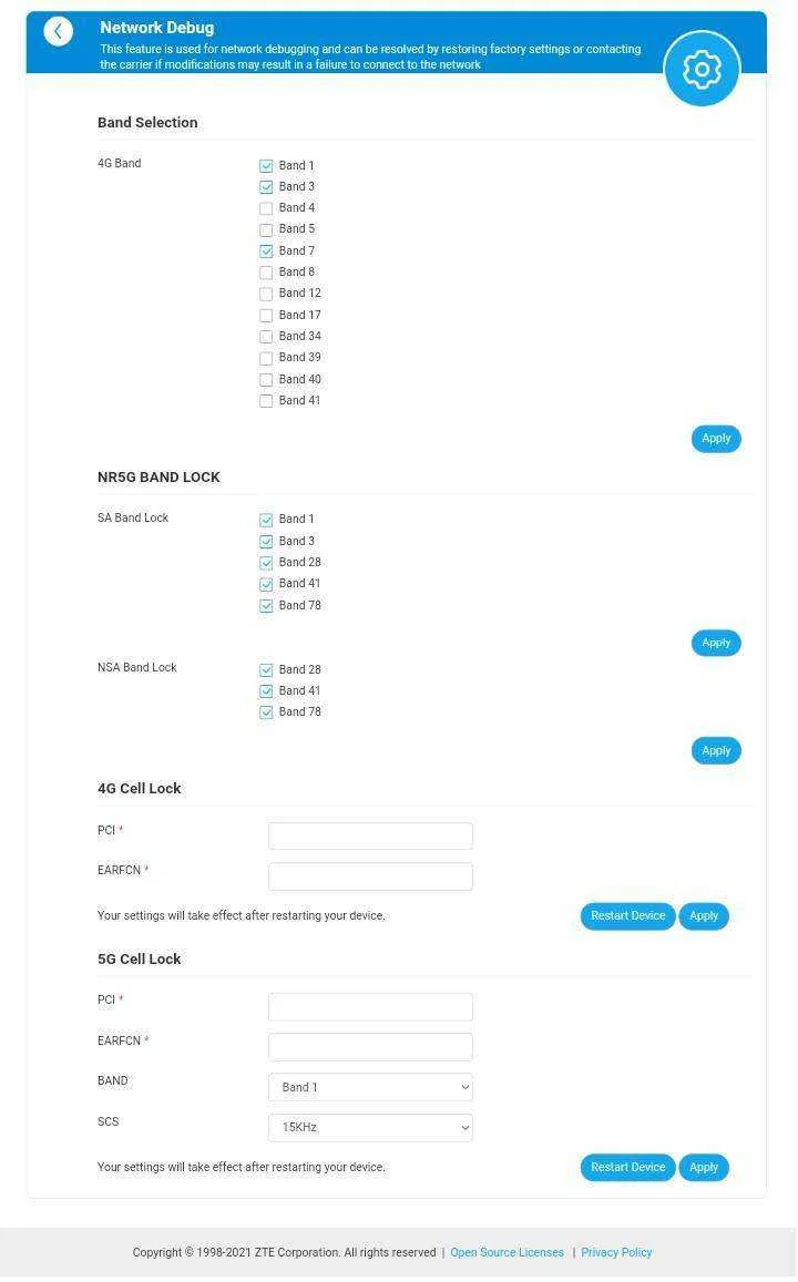

Pinaka d best ung zte 5g mc801a may bandlocking at cell if locking, na hidden teknik inde mahahanap sa google
