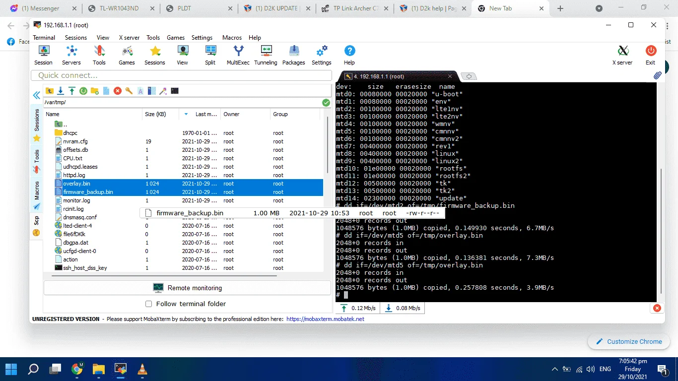

Eto complete process kung. Masundan mo checks links
Additional SSH DD wrt COMMANDS
ibackup at saka I-flash nalang files sa tmp eto yung command
Eto sample pag write mtd to temp
cd var
cd temp
dd if=/dev/mtd0 of=/tmp/firmware_backup.bin
Mtd8 linux -boot1
Mtd9 linux2 -boot2
mtd0 U boot
Commands pang flash
write dd-wrt-firmware_backup.bin u-boot

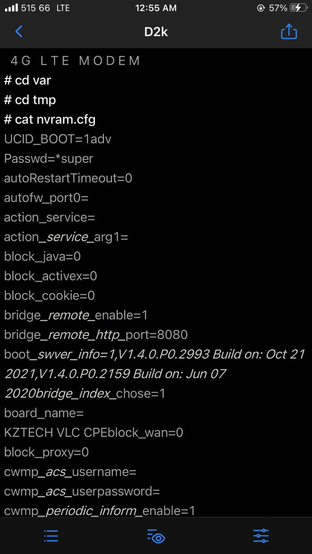

As i can see … ang old firmware nasa device pa kaso yung bagong firmware version ang na set for boot… antay nalng ako sa tamang panaho … at least now we know na possible pa rin na downgrade ang 2993 😻😻😻😻❤️

Hold your horses po muna, huwag excited. 😅✌🏻 Ayan ka nanaman kasi sa hasty conclusions mo po eh, parang nung napagkamalan mo lang na si D2K eh dating Wimax na based on older 65nm chipset at ginawang sim-based kamo po. Magkaiba ang Wimax sa LTE.
That screenshot only shows the current and previous firmware versions installed in the device. That will also show up in the Upgrade page as a Rollback function, for versions lower than 2993. You don't have any actual proof yet that redirecting the OTA upgrade server to a third-party for downgrading on 2993+ works. Like what he/she said, it only shows that the old version is still there, but he/she STILL can't rollback nor downgrade from 2993.
