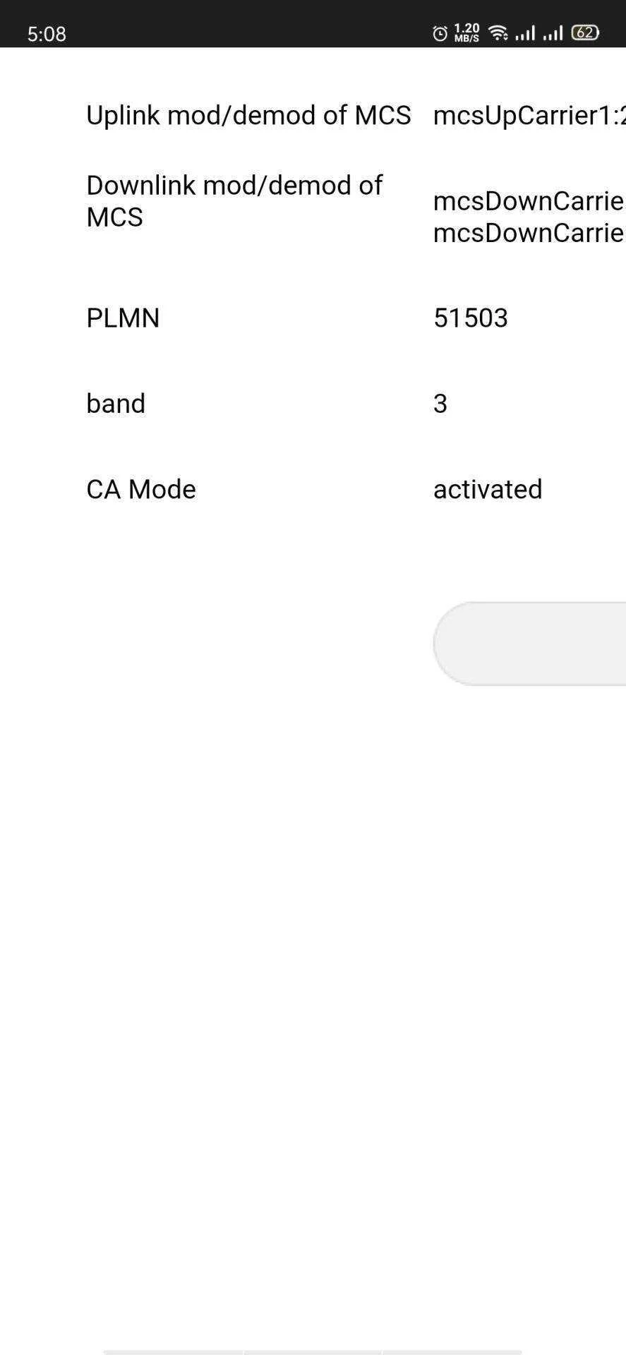

Hi ito ung information kung bkt naka deactivated ung status sa Huawei b818 CA mode.
Base sa research and experience ko ay naka automatic yan.
Ung sa globe ay medyo mahina sa area ko so palaging naka activated yan. Idk kung bkt ganun.
But sa smart may certain speed lang sya mag activated. Try mo mag download ng large file, or try mo mag speed test, mapapansin mo na automatic yan na ma activate.
Same speed parin before and after mag update ng firmware.
Sana maka tulong, lalo na medyo may kamahalan itong device pero worth it.

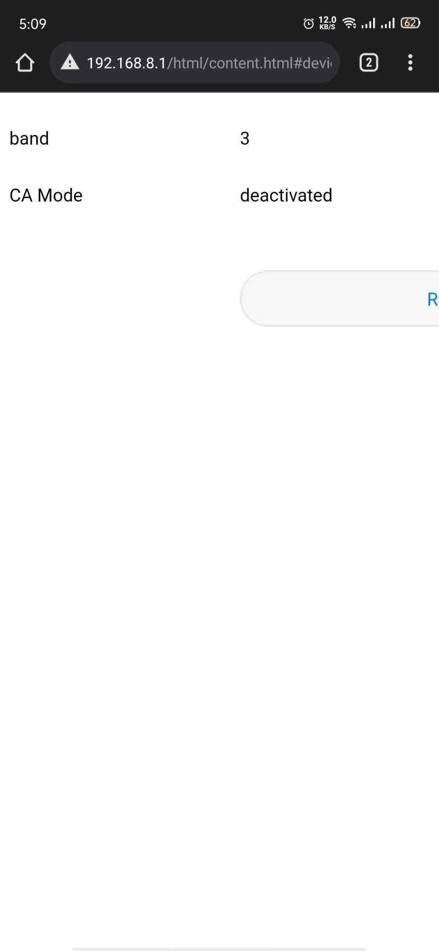

Carrier Aggregation may base po sa other bands or other towers. Maybe mahina yung ibang signals or bands kaya di sya naconnect. madalas kasi para mag CA yung 2nd signal mo -10 RSRP lang pagitan
I noticed that on B818 CA (aka LTE+) only activates when you actually download data and turns back to "deactivated" immediately when the connection is idle.
Tapos tumataas ung volts kapag naka LTE+.
hindi kaya ng USB connector kapag naka LTE plus.. may volts indicator kasi ung power bank ko kaya nakikita ko na tumataas ung volt.
