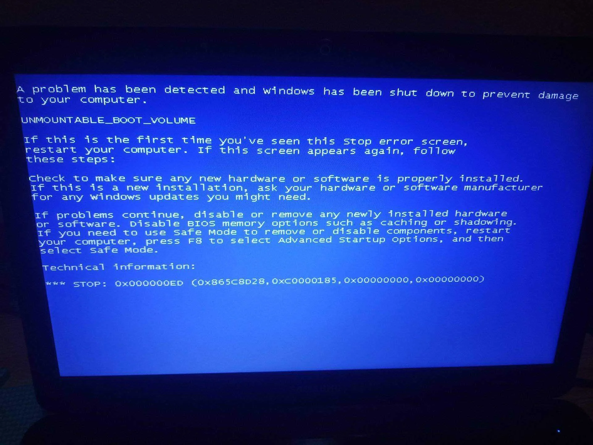

N NilagangBaboy Fanatic Oct 26, 2021 #2 try nu po reformat kung prob ang OS. Nailaw pa po ba ang indicator light pag ino on nyo?
N NilagangBaboy Fanatic Oct 26, 2021 #7 try running in safe mode sir kung nag pepersist pa din yung error.
O oydaks Fanatic Oct 27, 2021 #8 may tama na OS nyan sir .corrupted.reformat is the key.if may error pa rin, HDD na po papalitan.
J jstrlx Elite Oct 28, 2021 #10 HDD tingnan kung na dedetect. try i reformat. kapag ganyan pa din. subukan palitan na at baka matagal na at faulty na.
R Rskbr8kr Honorary Poster Nov 9, 2021 #12 Backup and format na yan TS, or try mo i-mount sa ibang PC yung HDD then check mo yung health ng HDD if worth it pa bang installan ng OS or need na ng replacement.
