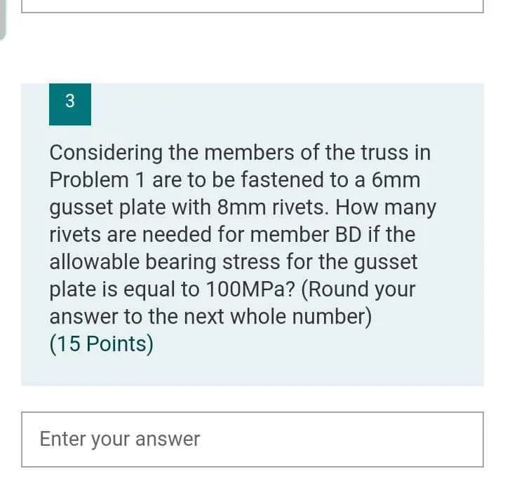

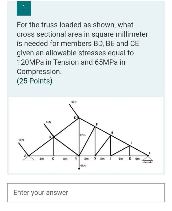

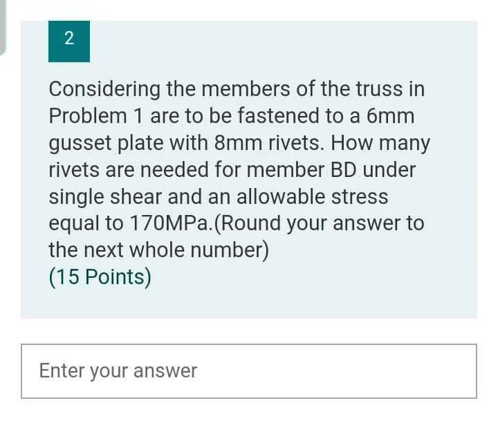

Pa help naman po sa problem na to, I'm an archi student and my friend at engineering department need help. Diko pa naman alam to hehe.. salamat po sa sasagot.received_607883717060581.webpreceived_465217771497936.webpreceived_3335874963310137.webp

Kunin mo muna Forces at those required segments (BD,BE,CE) by method of sections kung masipag ka pwde rin method of joints, syempre kailangan mo muna kunin ang reactions for hinge & roller supports. After getting the Forces at BD,BE,CE equate mo sya sa Stress=Force/Area may given knang stress at MPa (N/mm²) nka Tension & Compression, malalaman mo kung nasa tension/compression ang member pag ikaw mismo nagsolve pero may mga shortcuts naman just keep practicing & reading.

Una mong gawin ay magmethod of joints o di kaya'y method of section para makuha ang force in KN sa BD, BE, at CE.
