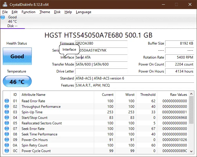

100% disk usage ganyan din nangyari sa akin. Check mo yung HDD mo using "CrystalDiskInfo" kapag nag CAUTION status yan may sira yung HDD. Bumili ka ng bagong HDD or SDD (Recommended).
If GOOD status naman ok pa yan pero need mo i-clean or optimize yung computer by removing unnecessary files.

same lng din ba yan ng HDD Sentinel? sa sentinel kasi chineck ko 100% health panaman sya

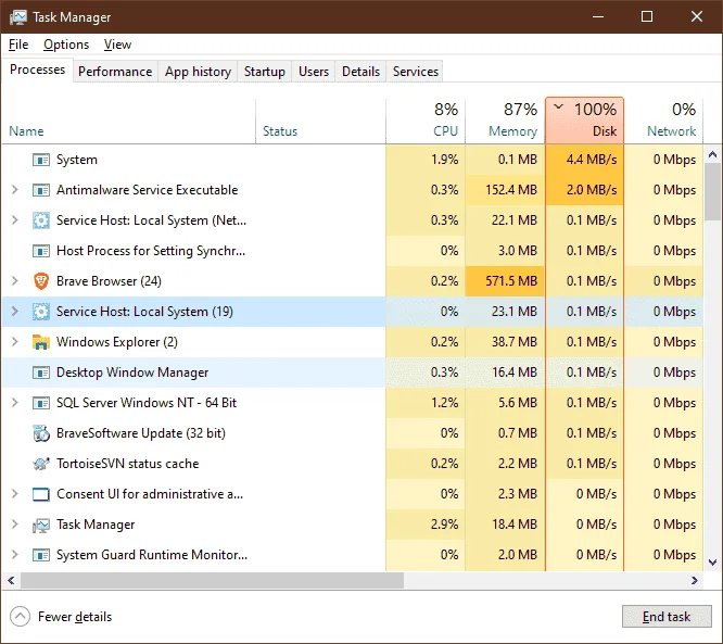

Can we have screenshot sa task manager mo po?
I advice upgrading to SSD, Disabling sysmain(prefetch) and windows update and automatic backup
Yan po sir, open 5 brave tabs. Paano po i disable ang automatic backup?
