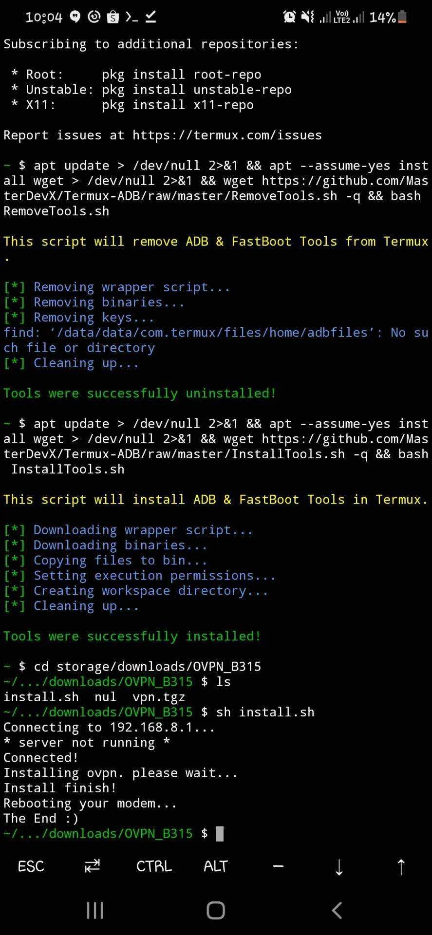

1st step Install Termux ( Playstore)
Dapat connected kayo sa wifi kung san kayo mag lalagay ng OVPN applicable models (936,938, 65a)
After open termux Grant Permission sa Storage
Command
-> termux-setup-storage
Press enter tapos may mag pa-pop up then click " ALLOW"
2nd Step Copy These Commands to install Adb/ or Copy paste
Command
-> apt update > /dev/null 2>&1 && apt --assume-yes install wget > /dev/null 2>&1 && wget You do not have permission to view the full content of this post. Log in or register now. -q && bash InstallTools.sh
Wait to install
Pag may nakalagay na ( "Tools Were Sucessfully Install tapos naka Green na sulat installed na yun)
3rd Step install na natin si OVPN
DOWNLOAD
You do not have permission to view the full content of this post. Log in or register now. 936 Modem
You do not have permission to view the full content of this post. Log in or register now. 938 Modem
You do not have permission to view the full content of this post. Log in or register now. Mamba
[/CODE]
Ovpn Credits ( Jerome Laliag)
Tapos Extract nyo
Note: Lagay nyo sa Download file sa Internal Storage tapos extract nyo
After Extracting
Tyoe these Commands or Copy Paste
Command
-> cd storage/downloads/OVPN_B315
Tapos may lalabas dyan (/downloads/OVPN_B315 $)
Type These Command
-> ls
Tapos may lalabas ulit na (/downloads/OVPN_B315 $)
Type These Command
Command
-> sh install.sh
Tapos wait nyo ma install
Ganito lalabas habang nag iinstall
Connecting to 192.168.8.1...
* server not running *
Connected!
Installing ovpn. please wait...
Install finish!
Rebooting your modem...

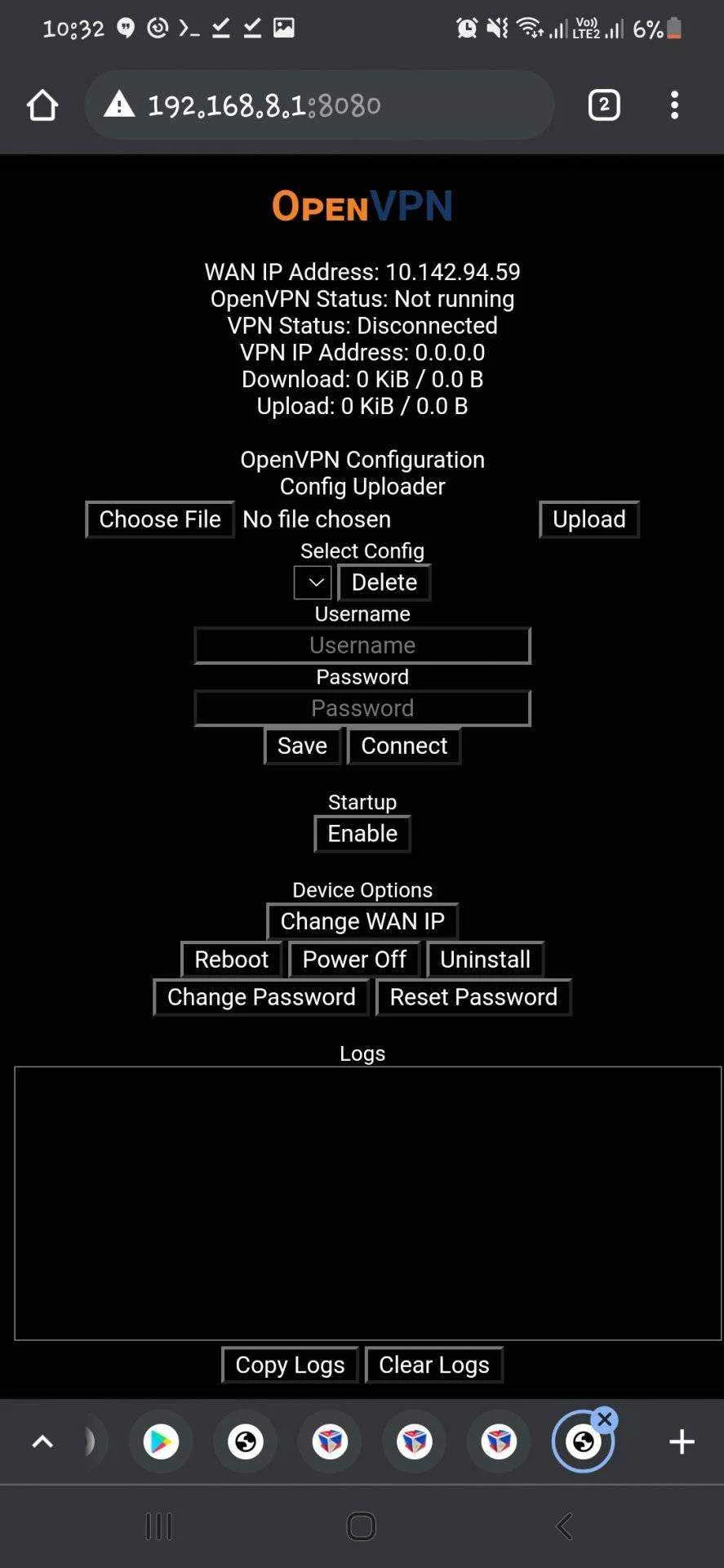

Note: After Installing mag Rereboot si modem
Tapos pag nag boot punta kayo sa Chrome Then Type nyo to
UN: admin
PW: admin
‼️Try at your own risk‼️
