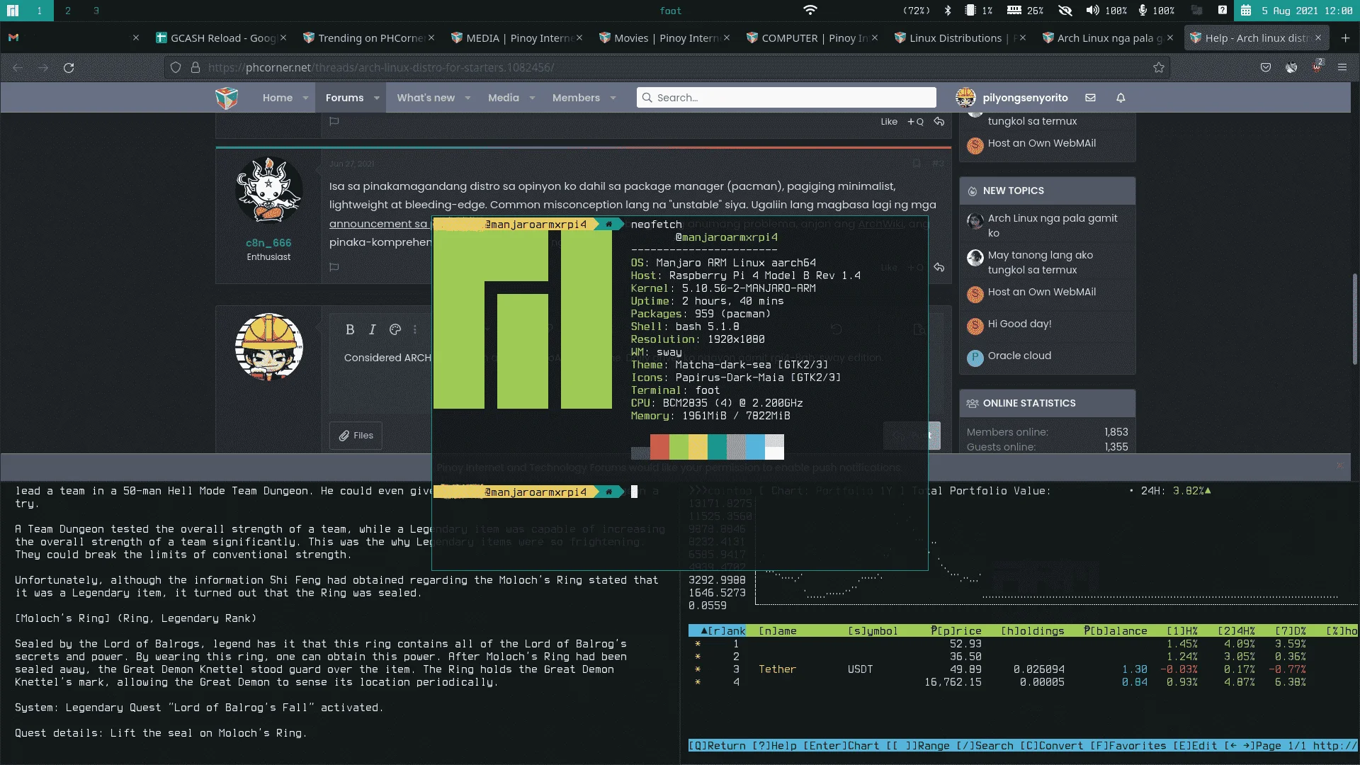

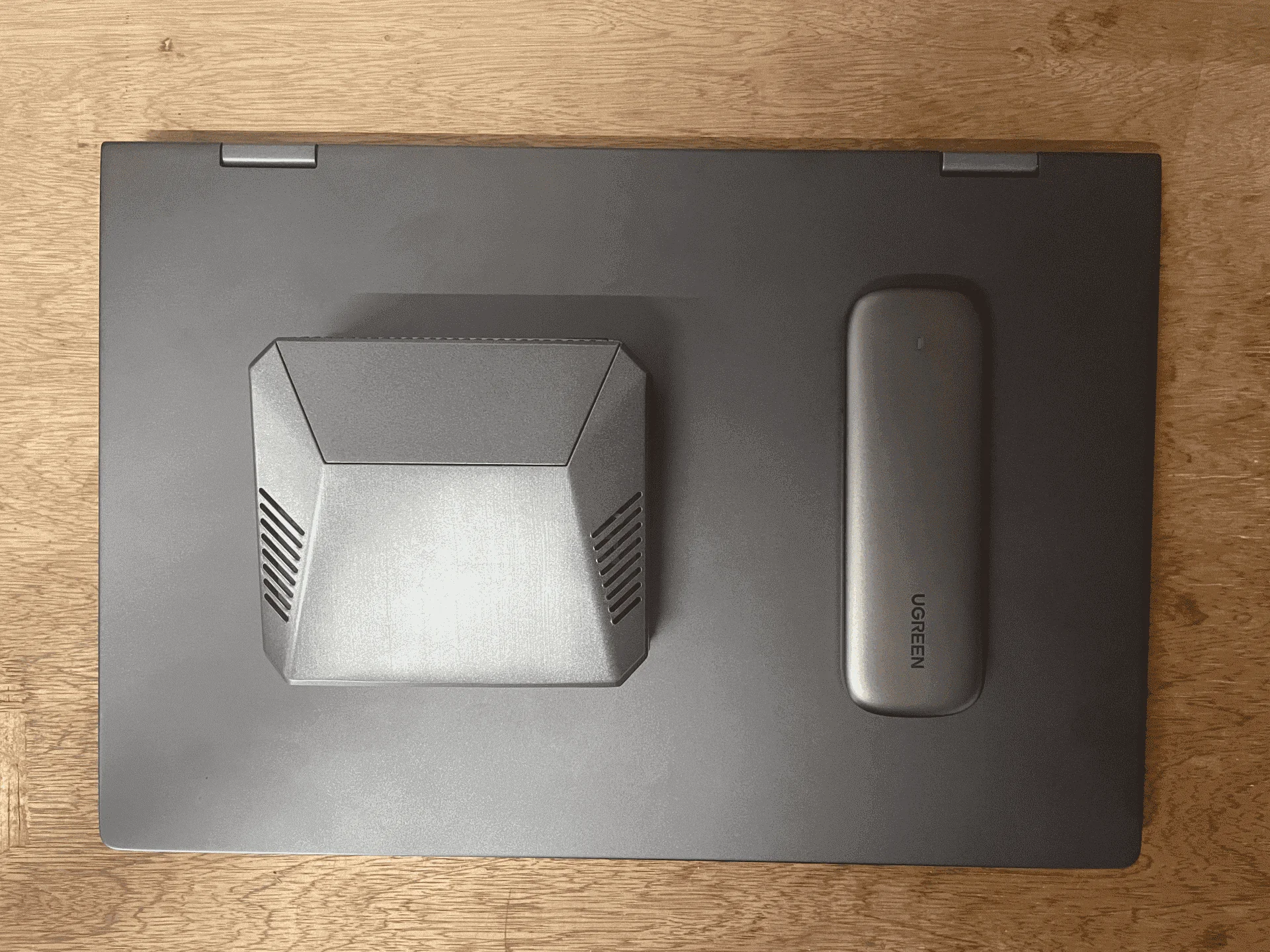

Raspberry Pi 4 Powered Lapdock - You do not have permission to view the full content of this post. Log in or register now.
System Running on ManjaroArm Sway Edition
What's Working?
a. Touch Screen
b. Keyboard (backlit)
c. Track pad
d. Speaker (with 3.5mm output)
e. SD card reader
Very nice setup.
How long to charge the lapdock and how long does the batt last?
Have you tried any other OS for your RPi 4?
For the Lapdock, takes 1 hr to full charge using the stock 20w charger then runs for 4 hrs.
Here’s the OS list that I have tried:
(1) Raspberry Pi OS 64 bit lite then installed KDE Plasma - 9/10
(2) System 76’s Pop OS for RPi - 8/10
(3) Ubuntu base then install sway wm - 8/10
(4) Konstakang’s Android Ports - 9/10
(5) Manjaro Sway - 8/10
(6) Open Media Vault - 8/10
(7) Raspberry Pi OS Lite Legacywith Myst Node, transmission and samba used as a headless media server and myst miner (latest current) - 10/10
