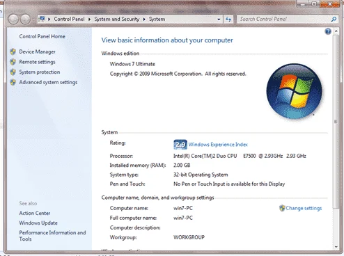

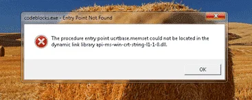

Tips naman dyan mga lods! bulok kase pc d2 samin e daming error sa pag rurun iinstall e :ROFLMAO: Need kase panggawa sa school e
low specs lang to pano kaya gagawin ko reformat ba o kung ano?

Try niyo po iupgrade yung ram atleast 4 or 8gb para po sa windows10 64bit. Tapos po bili po kayo ng ssd for os lang halimbawa 240gb ssd m.2 nvme or kahit sata 3 basta pure os lang nandun. Tas sa hdd mo nandun mga games and vidoes / music.
As with the other suggestions and based sa specs ng pc mo the way to go nga with as little additional cost would be to add an additional ram module, based sa spec ng CPU E7500 it supports either ddr2 or ddr3 check mo nalang actual ram module meron ka then add another 4Gb module siguro at least para 6Gb total;
You do not have permission to view the full content of this post. Log in or register now. -> possibly the cheapest ssd that you could buy. Then use mo nalang existing harddrive mo for your files.
If very limited talaga budget maybe go with the 2Gb ddr3 nalang P300 lang used sa shopee;
Then download mo windows 10 64bit ISO file from Microsoft, use RUFUS to make a bootable USB installer then install mo na windows.
tama.. reformat mo lang yan.. madami pa nman windows 7 dito sa phcorner.. kahit hanapin mo windowd 7 ROG edition.. pwede pa yan kahit 2gb ram lang yan.. o kaya instal mo windows 10 lite spectre.. pede na yan basta mainstall mo pa mga drivers nyan.. pero kung yan gusto mo mag upgrade dapat may pera ka... upgrade memory upto 8gb para smooth yung performance sa windows 10.. syempre upgrade ka din sa SSD kahit 120gb lang... swabe ang performance kapag SSD.. bilis magboot at read/write.. bumilis loading ng apps at games..
