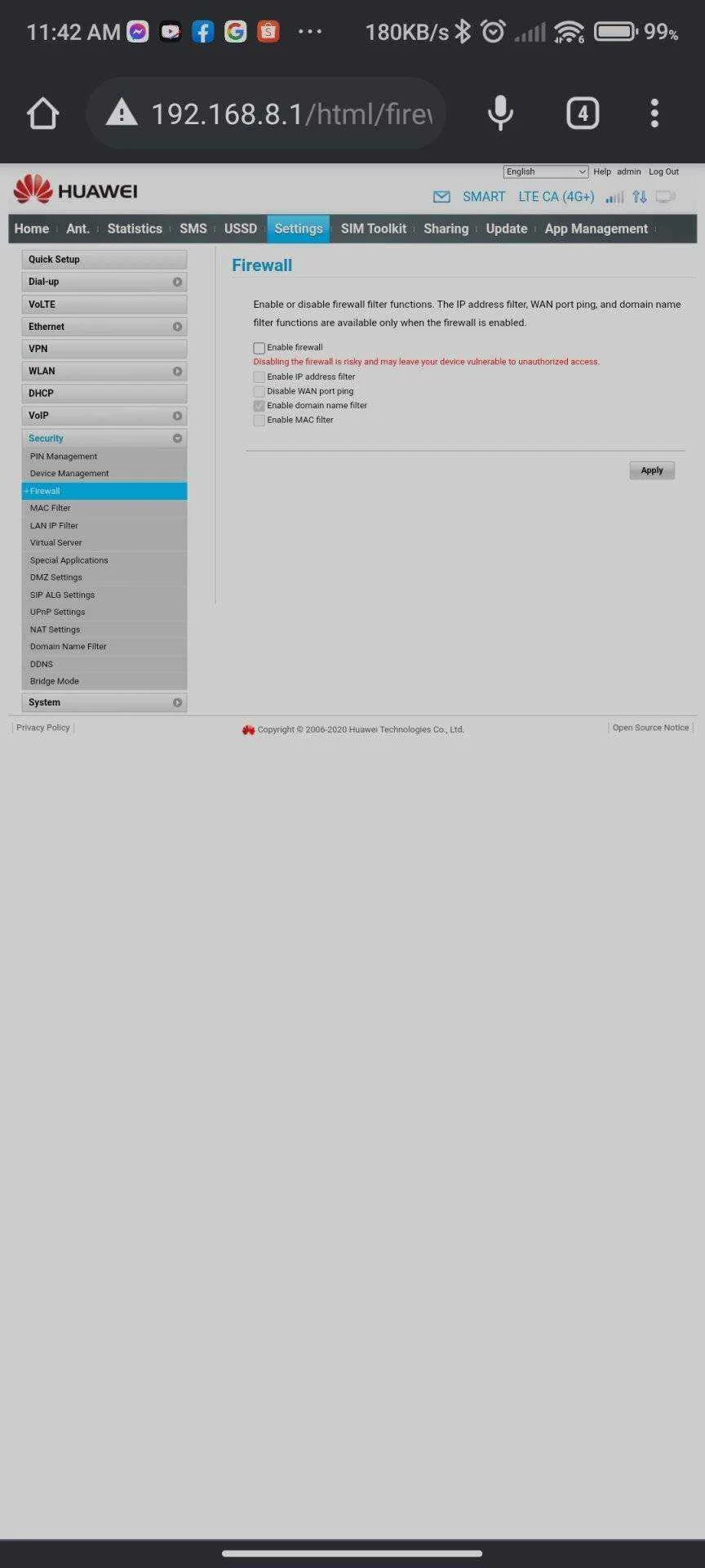

1. Go to Settings, sa B525s-65a. Then go to Security, then Disable the Firewall. Yung ENTIRE Firewall disable mo.

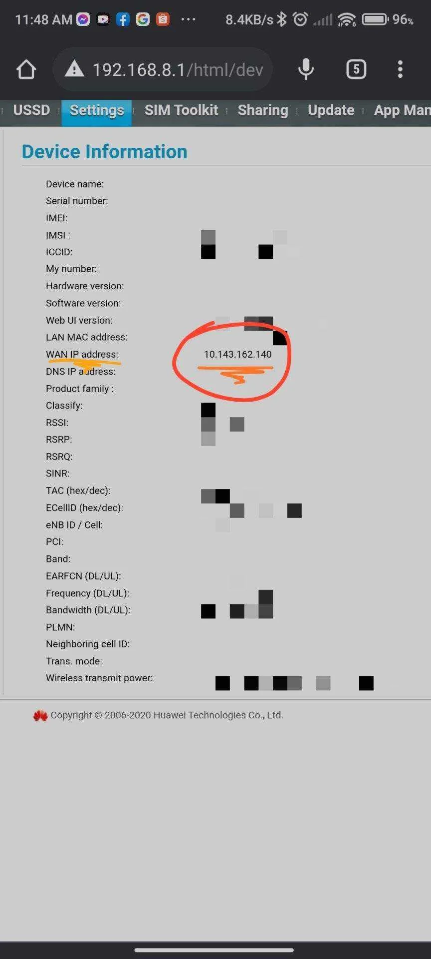

2. Go to System then Device Information. There, makikita mo yung "WAN IP". Take note of that number.
Now, using a SMART / PLDT connection. Open mo yung number na yun (Yung WAN IP). Internet connections other than SMART / PLDT like GLOBE or DITO won't open the configuration page of the modem. Dapat SMART / PLDT lang talaga.
Problem: Yung WAN IP is nagcha-change every few hours. Or everytime na magrestart yung WiFi. Si you'd have to get your parents to tell you yung WAN IP naman ulit.
