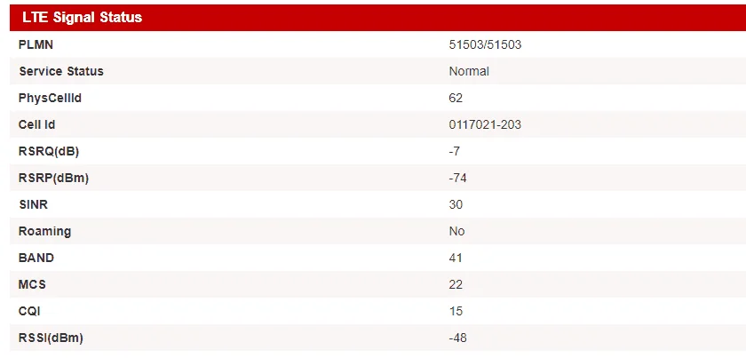

Kung Mababa SINR mo, makakatulong ung antenna. Bumili ako neto You do not have permission to view the full content of this post. Log in or register now.
tas naging ganito na signal ko: 1628718685037.webp
Make sure lang na alam mo kung san itatapat ung antenna mo. kasi directional pa rin xa.
