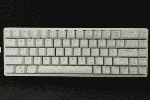

hingi lang po sana ako ng help sainyo about sa keyboard ko, im using rkg68 ask ko lang po bakit ayaw gumana ng F1-F12 keys niya pero working naman po yung numbers kapag pinindot.
for example i need to increase/decrease my volume f11/f12 not working po, isa pa yung alt + f4 kapag gusto ko mag exit ng mabilisan ayaw gumana po. Thanks in advance 🙌

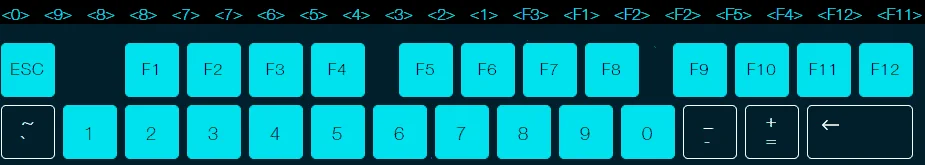

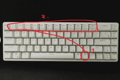

You can do Fn + Right-side CTRL to switch modes to have access to the media keys. The mode for the media keys disables the number keys; the number keys only work as functional keys in this mode. To switch back to the normal mode, just do Fn + Right-side CTRL again. I don't think it matters which machine is used.
