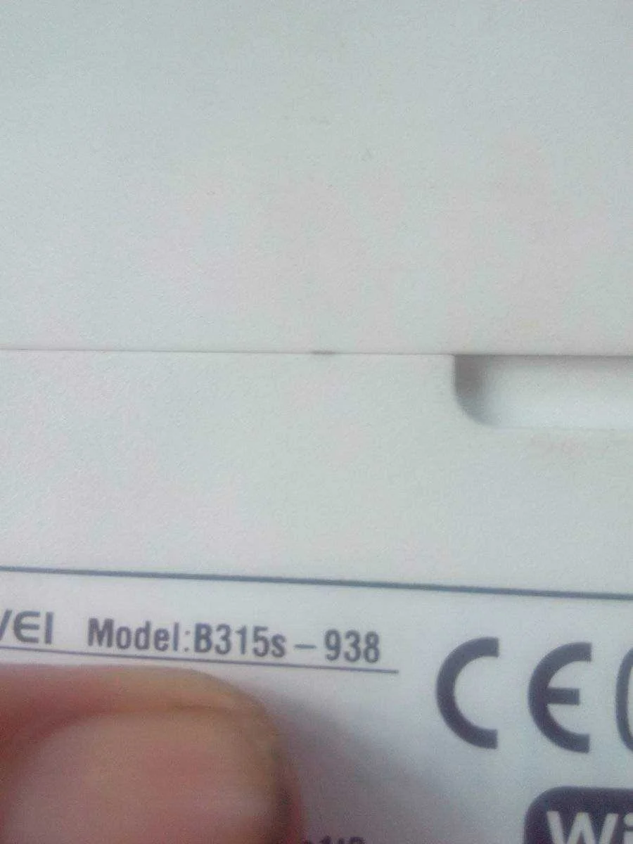

via cid reader ba to may admin acess tong akin problema pag nasa mobile partner aq usb mode no apn profile panu to?
same question here.
so panu ba? mahirap kasi mang hula nalang baka po kasi mabricks.haha
Nag eeRor po yung reply ni CID reader...paanu po ba sir?
