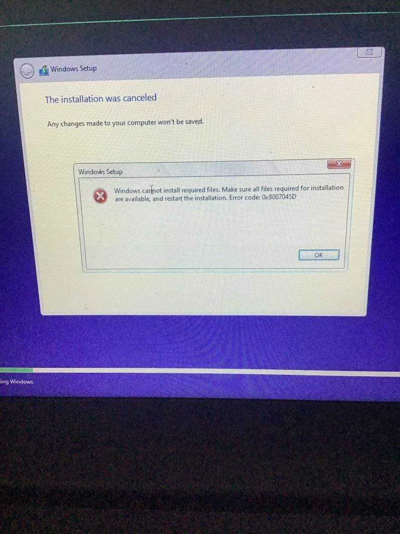

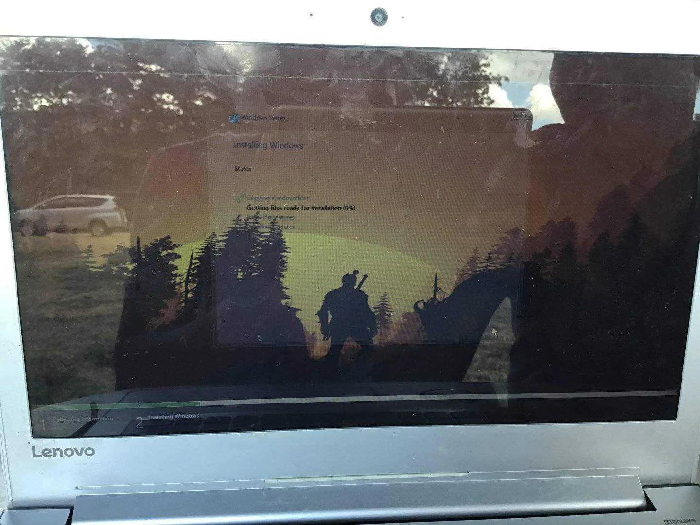

C1BA7261-F773-4927-BFF4-3C313FEB57A4.webp Na iistock lang po sya dyan mga sir maam. Current os kopo sya sa isang loptop kaso iinstall ko po sana sa isa ganyan padin kahapon papodi sya nag bibigay ng error code ganyan lang po sya.
1. Get a fresh copy of the OS you want to install from a different source/repository (sa original source mismo ka kumuha mas mainam). Compare the hash (MD5/SHA1) of your downloaded file to the source file to ensure that your download is not a corrupted copy.
2. Try using a different or better quality USB flash drive when creating your bootable media.
3. Do a clean install of the OS for best results. Check your destination drive if it is still a healthy/functional drive as well.
Hope this helps. 🤠
