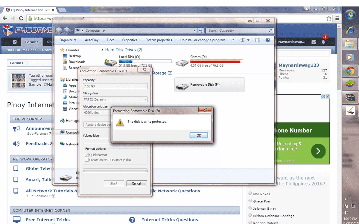

Ginawa ko na to ayaw parin talaga :( sad

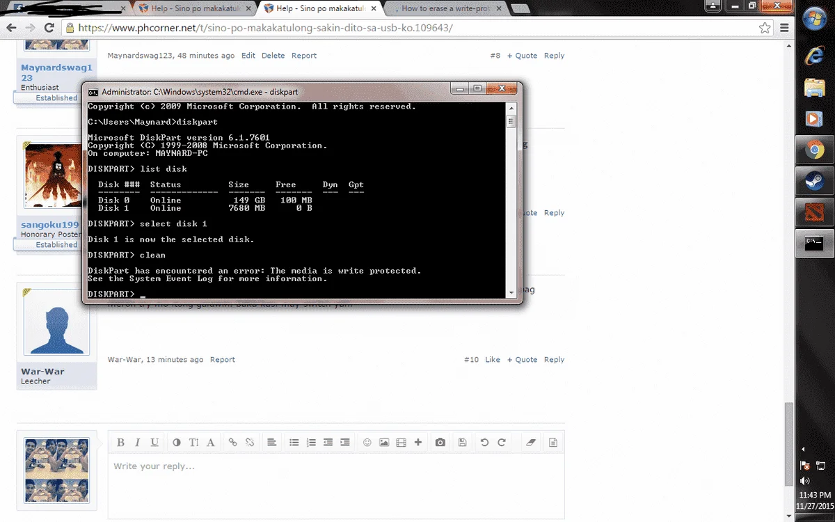

try mo yung diskpart method na nasa tut ng binigay ko na link.
Pagkatapos mong iverify if may check si "Write" under properties ni USB, open ka ng elevated command prompt ( Run as Admin )
Then follow this command
DISKPART
LIST VOLUME
Then select mo yung volume name ng USB mo
Then type this ATTRIBUTES DISK CLEAR READONLY
Let me know kung ano mangyayari
If na Clear mo na yung rad only sir and hindi mo maformat,Sad to say pero corrupted na si USB drive mo,last option mo is to download a tool to check if kaya nya iforce na maformat. PWede mo itry is Kingston Formatter
