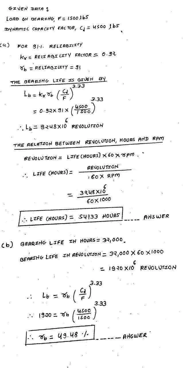

A radial ball bearing with a specific dynamic capacity of 4500 lbs. is to carry a load of 1500 lbs. The bearing shaft rotates at 1000 rpm. Evaluate, (a) the maximum period over which the bearing could be used safely if reliability is 91 percent. (b) the reliability if bearing life is 32,000 hours.
Expert Answer

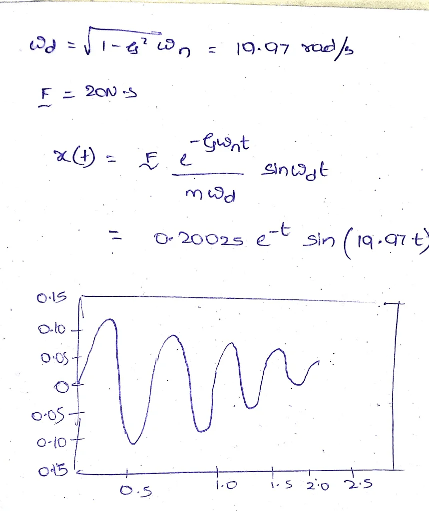

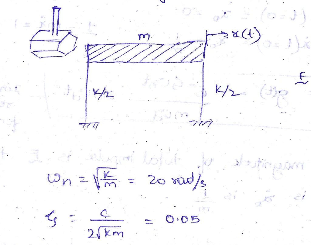

In the vibration testing of a structure impact hammer of a load cell to measure the impact force is used to cause excitation. assume m=5kg, k=2000N/m, C=10Ns/m, E=20Ns response of the system
Expert Answer​
