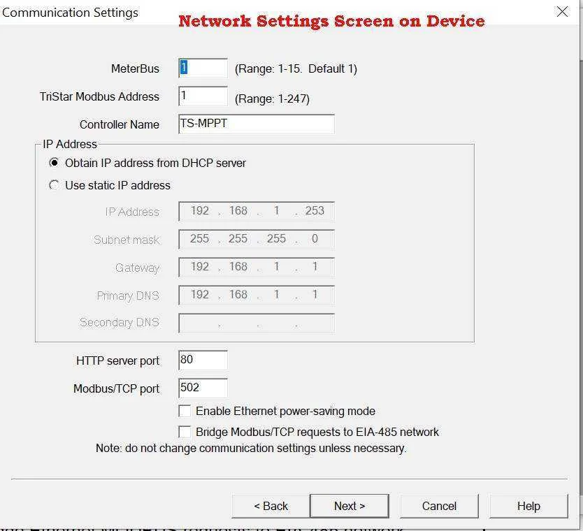

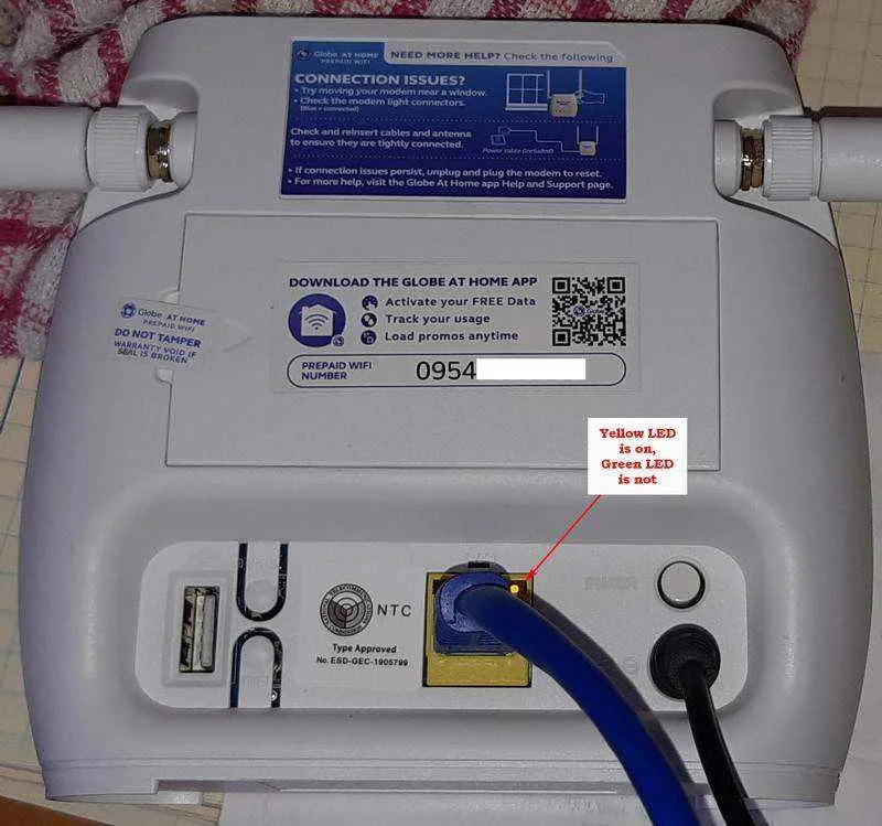

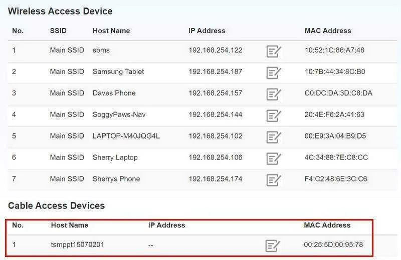

Hi all. I have searched all over the internet for any info on this, but have yet to find any useful info. I have a GAH ZLT S10G running (stock) firmware S10G_2.03.3 with a Globe GAH sim. It has been running well for the past year. I am trying to connect a device to my LTE network that only had a network cable connection. When I plug it in to the s10G, it shows up in the "connected devices" list, but has no IP address assigned. DHCP for wifi connected devices is working OK.
I have already openlined the S10G and have full admin access. Is there somewhere to designate to the device that this is a LAN connection vs a WAN connection? How does it know?
I have previously connected a Raspberry Pi using the same cable and connection, and the RPi connected fine, was allocated an IP address and had internet access. This device is a solar charge controller designed to connect via cable to the internet. It is set up for DHCP, and works fine with the cable connection on another router. I have tried resetting the S10G, and the device. I have tried another cable (though the original cable works fine on another modem).
Any ideas as to what could be the problem? Thanks in advance for your suggestions.

Thanks for your reply. The device is a Morningstar Tristar TS-60.
It works fine with DHCP on the other router I have (but that one has no internet connection). The other is a Mikrotik router running RouterOS.
One other thing I tried without success was to set the solar controller to a fixed IP address on the S10G IP outside the DHCP range (192.168.254.99). In this case when plugged in to the S10G, it did not show at all in the device list. So now I couldn't talk to it at all. So I had to change my Mikrotik router settings to the correct IP settings (to match the S10G's), and it connected right up.
Note the the Mikrotik router is NOT connected to the S10G, it is just another router (with no internet connection) that I have been using to talk to the solar controller. But I'm trying to get everything on the S10G.
My main question is... is that Ethernet plug on the S10G really both a Lan or a Wan connector? Obviously it could only function one way at a time. Is it designed to allow you to plug in the S10G to a cable modem, for example? (a WAN connection). Or is it designed to allow you to connect a desktop via ethernet cable to your network? (a LAN connection) Or both? Is there a configuration setting that tells it which?

Also, I have just confirmed that DHCP is working fine on the S10G cable connection--I connected a Raspberry Pi via cable and it shows up in the S10G device list under the cable connection, with a proper IP address and can access the internet through the S10G. So I guess it's something in the way the solar controller is connecting.
