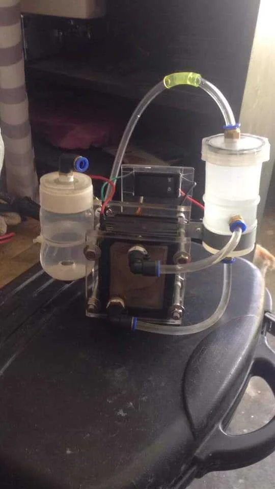

Payo ng isang veterano sa pag sesetup ng HHO Generator:
1. Amps - sabi ni Michael Faraday electrolysis cells raw can support up to 0.084 amps per square cm without overheating. Kaya wag sayangin ang kuryente at distilled water, panatiliin ang temperatura at amps. Note: dumi tulad ng alikabok nakakaapekto sa conductivity ng tubig, maari rin itong sanhi ng pag dumi ng plates dahil kumakapit ang minerals sa plates during ionization kaya panatiliin ang purity ng solution
2. Water and electrolyte - para manatiliing malinis ang plates at tubig, gunamit ng distilled water at ang pinaka magandang electrolyte ay yung gawang KOH. Sa timbang panatiliin na ang 1 is to 9 base sa bigat ang koh to distilled water. Bantayan ang amps base sa #1 ang amps (tuning voltage or pulse), kundi baka kulang na sa parte ng tubig. Ang KOH kung maintained lasts for a year or two depende sa gamit.
3. Voltage - depende ito sa number of cells at conductivity ng electrolyte, and importante yung #1 ang amps
4. Hours - ang concern dito at madalas buhay nang power supply at init. #1 ang importante, kaya gumamit ng properly sized long running power supply.
5. Pag masyado nang malayo nung bago pa ang plates at setup compared sa production mo ngayon (ex. Humina na liters per minute), time to disassemble and clean your plates or check your wirings, power supply, concentration of electrolyte to water ratio
How to clean a generator/electrolyzer HHO?
1) pour isopropyl ******* into the generator, to degrease any oil residue on the plates of stainless steel. Leave it for half an hour. Following rinsing with highly purified water.
2) Passivation & crusting removal:
Dissolve 200 g of citric acid in 1L of highly purified water, enter it into the generator and leave for 2 hours. It will remove all residues minerals.
NOTE: While cleaning the HHO generator must not be energized.
Disconnect the generator from electricity.
3) Rinse everything with highly purified water
