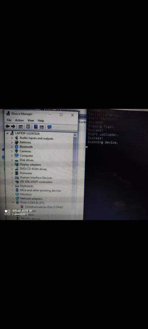

Mga boss,sira na modem ko..di na ba to maayos?

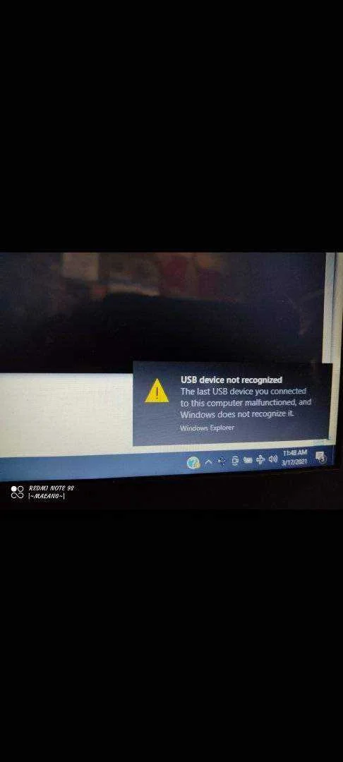

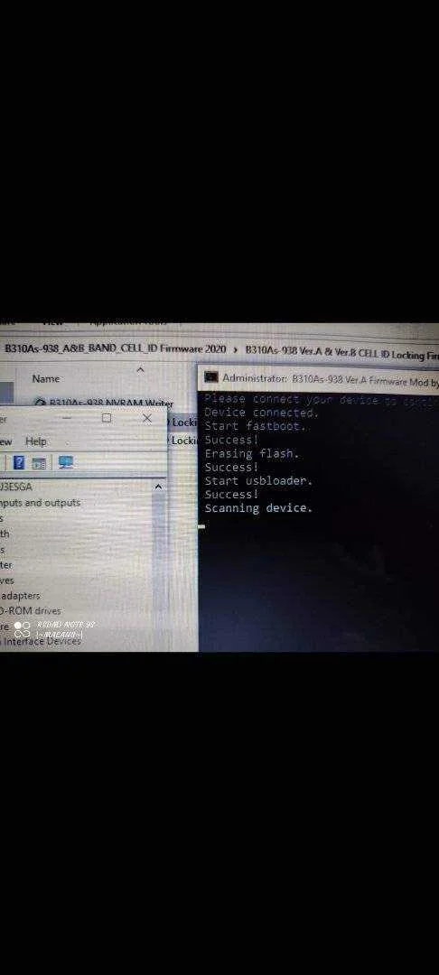

nag try ako mag openline,kaso nung sa scanning device na..biglang nag promt na usb not recognized
kaya unplug ko nalang ung usb,then ngayon ayaw nang gumana ..ung power light lang nag iilaw

[XX='PHC-Ganyu, c: 942869, m: 774763'][/XX] Ito ang gamitin mo boss na firmware..
B310As-938 V1 and V2 or -B Private Release Stable _AT Complete Files with Tools and Tutotial:
  • Link: You do not have permission to view the full content of this post. Log in or register now.
  • Password : $331045-938J3R0m3L4L146

Possible ba boss na ung ginamit kong cord ang may deperensya kaya nag error?
pero okay naman din kasi sya sa una..di lang tumuloy dun sa scanning device

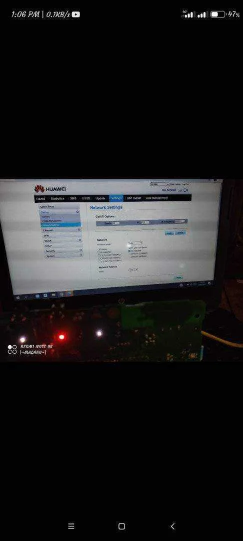

[XX='Min3, c: 943187, m: 1310892'][/XX] opo,nasalpakan ko na kaso red pa rin..walang signal dto ng smart 😅
pero nung pumunta ako sa dashboard nya,hindi na nanghingi ng unlock code..success naman nakasulat nung ni run ko ung unlocker na program
