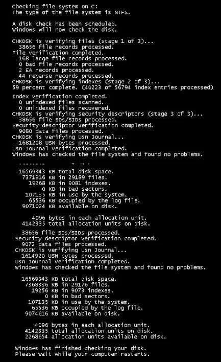

Mga lodi patulong po.
Palagi po nag shushutdown ng kusa ang pc namin. Lumalabas po yung kulay blue tapos magrerestart din ng kusa at mag chechekdisk po.
Patulong po mga lodi. Nahihirapan na talaga ako.
Sana may matataba ang puso.
Ganito po ang lumalabas
hintayin mo lang..tapos pagganyan parin..check mo cable ng harddisc pati supply cable..remove linisan kunti tapos balik mo..
pagganon parin..bili kana bagong harddisc..
I think that is faulty OS so it needs to format, chckdsk is detecting some bad sector. The hard drive will soon died, it nears to his life span. So better to format it and don't put some heavy games or heavy softwares next time to prolong your hard drive.
[XX='Jopax321, c: 937706, m: 1701732'][/XX] try mo na lang mag refoemat kung sakaling wala namang important files jan sa PC mo, or kung meron man backup mo na lang, tapos download mo yung windows 10 potato ni ghost spectre para magaan lang, tapos yun na lang gamitin mong OS and gamit ka na lang din ng ibang USB para gawing bootable kasi minsan nasa USB din ang problem, tapos kung ganun parin ang nangyare mataas ang possibility na yung HDD mo may bad sectors na
[XX='Jopax321, c: 937719, m: 1701732'][/XX] So nabubuksan pa pala, best way eh i-defrag mo yan to fix some bad sector kaya nag pop up yang chckdsk detecting some issues. Medyo matagal ang pag defrag pero atleast it can fix some issues.
