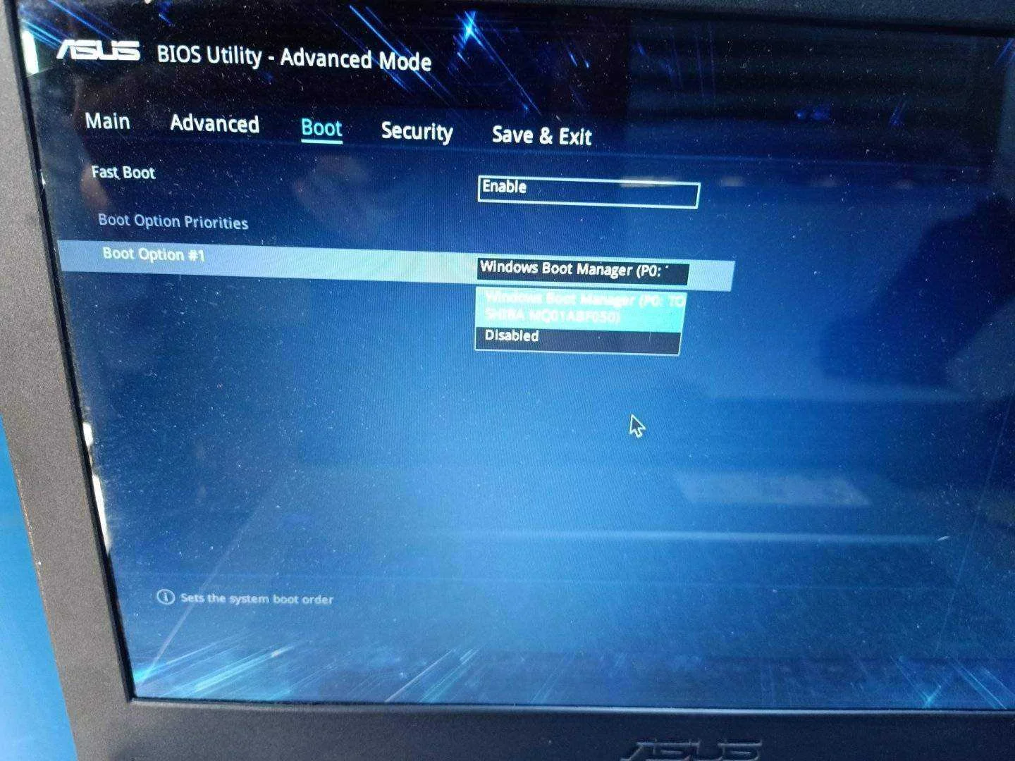

bigla nalng yan lumabas, kahit patayin mo tapos buksan mo ulit yan parin lumalabas
hnd nawawala sa bios idol kahit exit mo? o kapag exit mo nagloload din yung OS?
Kung puro bios lang lumalabas kahit exit mo wala siya nade detect na bootable disk check mo baka lumuwag yung sata cable ng hard disk mo idol
check mo muna yong boot priority kung may nakikita siyang bootable device, pag merong nadedetect try mo magpalit ng cmos battery para masave yong configuration nya.. pag wala namang nadedetect na bootable device palit ka ng sata cable or baliktarin mo yong dulo ng cable board to hdd reverse
[XX='DavidJhay25, c: 865718, m: 1631565'][/XX] hmmm, hirap mag troubleshoot pag di nakakamayan ahaha!!! kahit ba mag load optimized default ka ganyan na din??
kung OO try mo gumawa ng isntaller mo para makita mo kung mag boot yung installer, at kung nag boot yung installer ibig sabihin nun may problem sa OS mo, and sad to say na need mo na mag format nun
Solution 1: Bios> Save&Exit> Tas piliin mo yung default settings and exit
Solution 2: Startup repair kung wala ka makita na ganyan restart mo pc mo tapos click F10 once na magstartup may lalabas blue na screen with options> nakalimot na ako jan pero explore mo lang hanapin mo yung startup repair jan
Solution 3: Hindi ako sure pero try mo magbios reset...
Solution 4: Reformat or Install new OS
