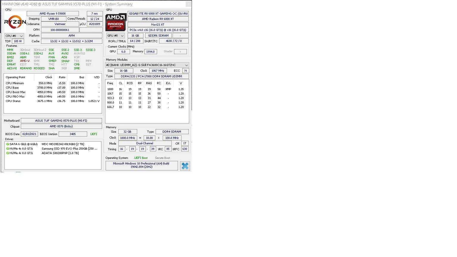

kakaupgrade ko lang ng CPU at Videocard bali ang problem ko nung ng upgrade yung Archeage after Start Game blacksxreen n sya then after 3-5mins bumabalik n sya sa windows user login. Nag update/downgrade na ko ng driver, tinest ko rin alang driver installed, delete yung Archeage setting sa Document, reinstalled game, Overclock/Undervolt GPU at restore default at reset cmos pero same result pa rin. Iniisip ko tuloy Gameguard nagcacause since working sya sa ibang game at bnebenchmark at stress test ko both cpu at gpu no problem nman at acceptable temperature niya.

from 2070super before gumagana siya and alang nadedetect yung gameguard ang naiisip ko lang yung mismong 6800xt tinitira ng gameguard hindi ko sure kung ano. Kasi tinry kna rin na alang Avast yang lang ang nasa startup program ko at tinry ko rin ng alang videocard driver same result.
