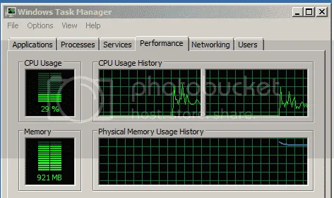

To check the ram usage open your task manager and check the memory usage graph in the performance tab.
High Ram Usage With Work Load – If your computers use the ram usage above the 90% while working and you got the blue screen or any other ram problem that means you should upgrade your computers and laptop ram because your computer might need’s the more ram to handle the work load.
High Ram Usage Without Work Load – If your computer usage gone higher without any of work load and you see one of bad ram symptoms then its probably not a ram problem because sometimes corrupted widows can cause this types of problem too. So, you can try to reinstall your windows to test does this problem comes from your ram or from windows (OS).
Before you’re going to reinstall your windows, first I would recommend you to try our next ram testing checkup because installing windows is so much work to do and wasting time for bad ram isn’t worth it. So, stick with our next checkup and the test will definitely confirm you about your ram problem.

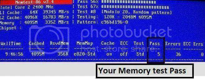

Memtest86 is great utility software made by Pass MarkĀ® Software which can run a boot memory test to identify any type of ram problem on any computer and laptop. You can download this free bootable software at given link below and also follow the instruction shown in listed video below the link and it will helps you to test your computer’s ram at free of cost.

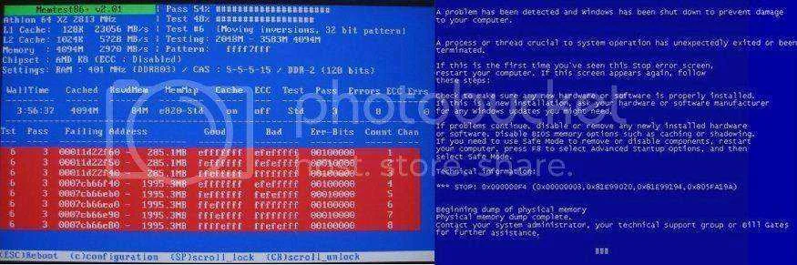

I suggest min 5 pass and mix 10 pass to identify your ram is working in great condition or not.
If you see any of the blue screen or red line error between the running Memory Test that means you having a problem with your ram stick and your ram might need to get replace.

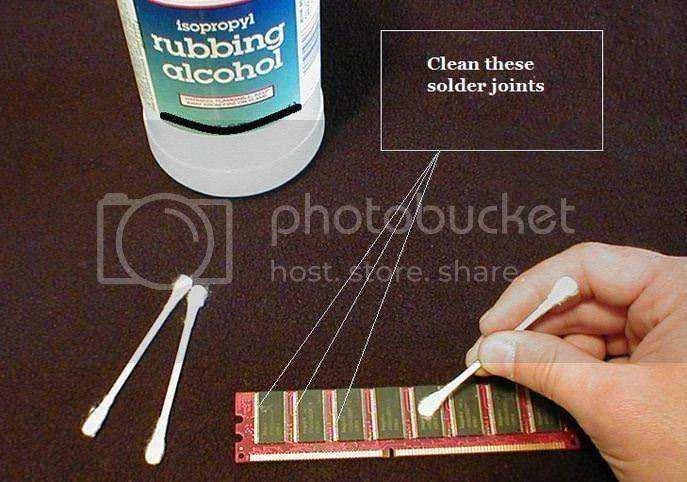

If you find your ram faulty or not, there is two more thing you can do to fix your ram and those are ā€œram cleaningā€ & ā€œram slot changingā€
Ram Cleaning & Slot Exchanging – Remove the RAM from the slot, clean it and place it back properly. If you have two ram installed in your computer then take out all of your ram from the motherboard and place only one ram into the slot for testing, if you are able to use your computer without any problem that means your another ram is faulty buy a new one. If the problem still exists then try to do the above procedure with the other ram with Slot Exchanging
>>You do not have permission to view the full content of this post. Log in or register now.<<
If the cleaning procedure doesn’t work for you either then changing new ram is an only option you can do to fix your computer from a ram problem. Listed link below will helps you to install a new ram.
