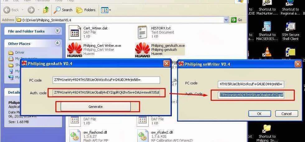

1. Download the tools above if you already download the firmware posted on Dec that tools was included on the zip file

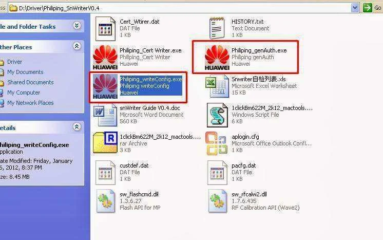

2. Extract open the two application
WriteConfig and genAuth.exe

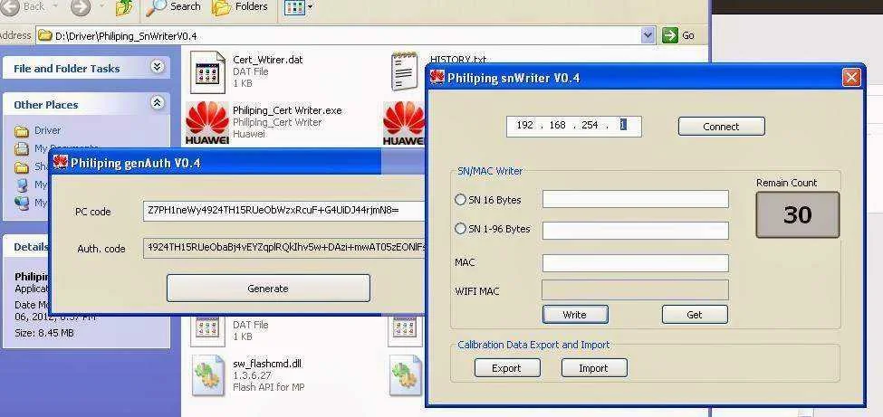

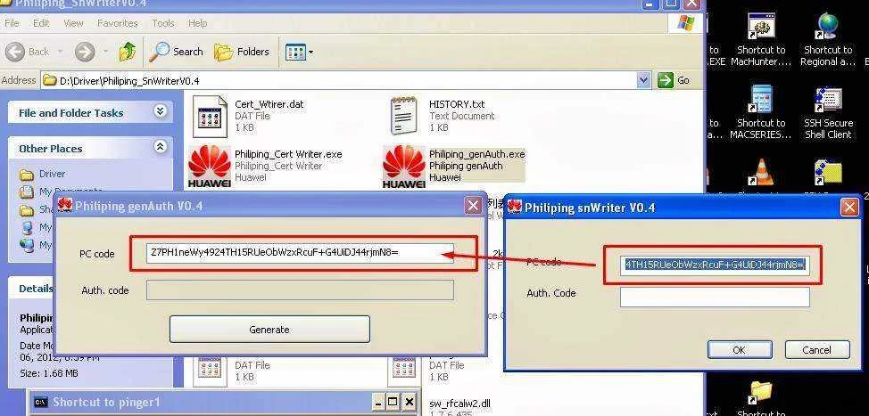

3. High light the PC code on snWriter paste the PC code on genAuth
4.
Click Generate and then copy the Auth. code paste it on snWriter click OK
5. EDIT the IP address 192.168.254.1 then click connect

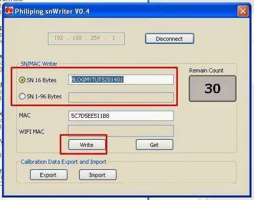

6.You can now EDIT your SN choose which bytes you want

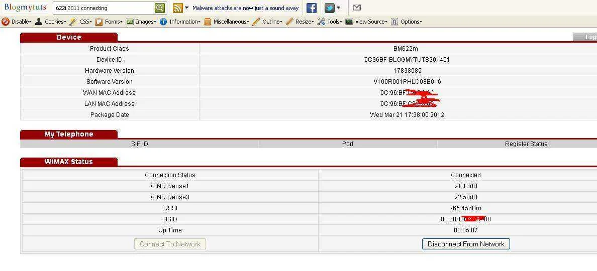

click write then reboot your modem to make change SN take effect.

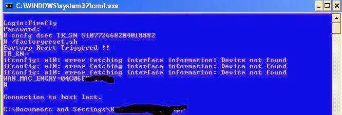

Sample:
ALTERNATE via Telnet Command
Set cloner = CreateObject("WScript.Shell")
cloner.run"cmd"
WScript.Sleep 500
cloner.SendKeys"TELNET 192.168.254.1"
cloner.SendKeys("{Enter}")
WScript.Sleep 500
cloner.SendKeys"Firefly"
WScript.Sleep 500
cloner.SendKeys"$P4mb1h1r4N4m4nT0!!"
WScript.Sleep 500
cloner.SendKeys"sncfg dset TR_SN 510772668204018882"
WScript.Sleep 1000
cloner.SendKeys"/factoryreset.sh"
You can use reboot command only if your don't like /factortyreset.sh
