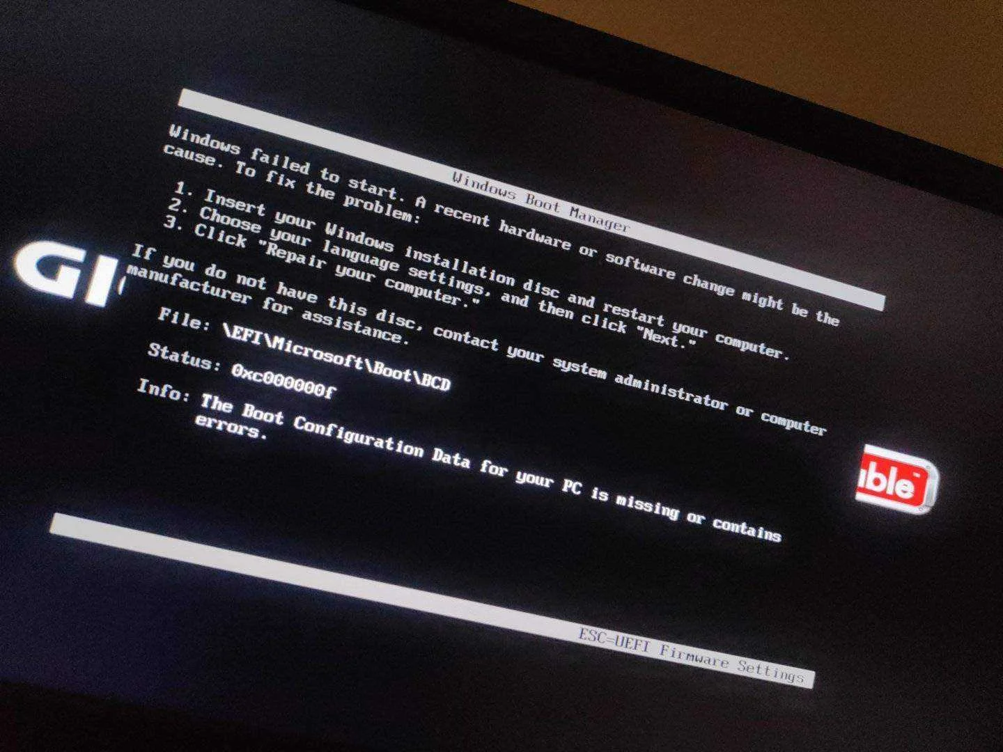

Ito yung nangyare....
I was so excited to transfer the mb's and other stuffs sa system unit ko.
Kasi bumili ako ng bagong case. Then, while I was testing to turn it on. Nahulog yung hdd ko. Na unplug both sata. It says Windows Boon Manager
What do I do? Wala pa akong usb para mag flash :<
[XX='Queen Kaikraiy, c: 654773, m: 740200'][/XX] Oo paps, pero try mo muna linisin yung sata connector (yung hard drive to motherboard connector). If di parin siya magboot baka nasira na talaga yung hard drive.
check mo sa BIOS kung detected pa HDD mo, try mo din mag palit ng sata cable o kaya hugot tapos balik ng sata para ma detect, kung wala pa rin check mo baka madami nang bad sector yang HDD mo
pwede ka din mag startup repair, saksak mo installer mo (same OS dapat) tapos select language then click repair my computer tapos sundan mo na lang yung step by step nya
