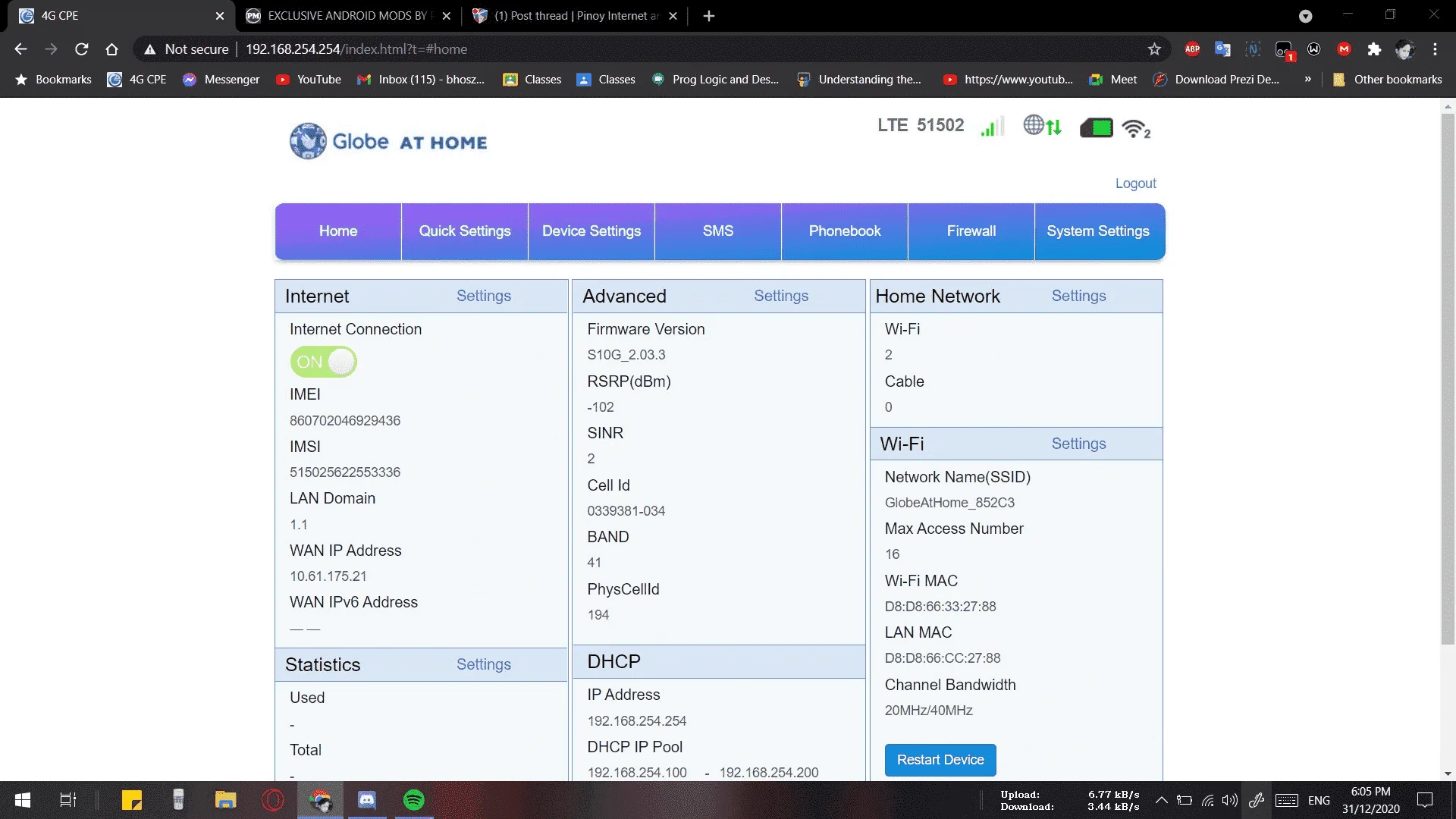

L Lucyna Kushinada Eternal Poster Dec 31, 2020 #1 okay naman signal ko 3 bars pero periodically nawawala ang internet connection tapos naga kulay red yung data sa modem. Pano kaya to, nakakayamot kasi kapag naga online games ako bigla nalang naga disconnect Attachments 1609409139648.webp 139.2 KB · Views: 41
1 1neWay Forum Expert Dec 31, 2020 #4 Check mo for the following.. Area ninyo Signal mo sa modem Try mo sa band settings Try mo Cell ID Locking(May tutorial niyan) If ayaw lahat, Use Reset Button..
TS TS L Lucyna Kushinada Eternal Poster Dec 31, 2020 #6 naayus ko na sir yung cell id locking ang ginamit ko maraming salamat happy new year na din
