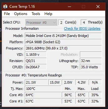

try mo install to boss core temp at cpu-z, tapos post ss mo para makita na namin... gumagana pa ba battery ng laptop mo? built-in ba yan o removable battery? try palitan yung charger laptop mo boss hiram ka mona sa iba
